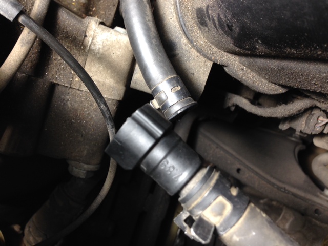

what is this part?
Preparing my motor for the drop. All plastic parts are brittle in a 12 year old car. Snapped this puppy in half and I don"t know what it is/does. it"s in the middle of a coolant hose in the rear right of the engine compartment.. I think it"s the oil cooler coolant hose.post-89052-0-16759200-1386547682_thumb.j
It "might" be 996.106.255.01 known as a flat connector. The qualifier is if the rubber hose section leads to the oil cooler.
If the link below works...It should take you to a graphic with the part. According to Pelican, it's a 2.00 part, but a special order so additional fees "might" apply.
http://www.pelicanparts.com/cgi-bin/PartsLookup/search.cgi?command=show_page&Catalog_Name=986_USA_KATALOG&Illustration=104-00&Line_Item=33
Edited by zodman
Hmm...could be that. I thought it was a connector but when I tried to disconnect the connector it disintegrated! Seems a bit dumb to attach a fragile connector with two spring clips. Maybe I don't understand German engineering. :huh:
I'll follow the lines tomorrow to make sure I'm not misleading everyone.
Edited by NewArt1
Okay, got it out and took a good look. It's a quick connector. There was a button on it which I was supposed to push (and not pull ) which broke. Then I broke the nipple on one end and the flange disintegrated. But it's just a $2 part.
