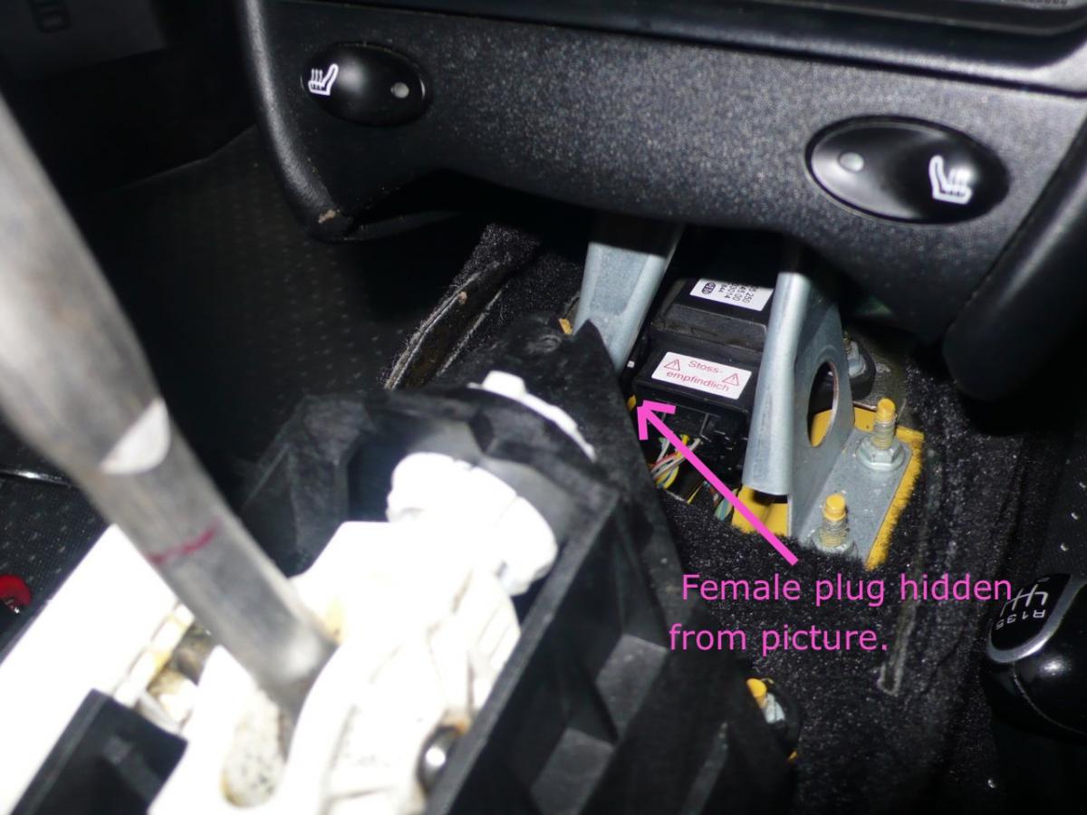

Plug at Console...

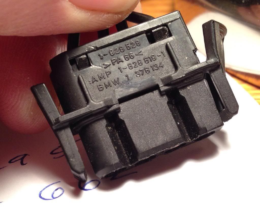

It is used for the OEM Phone Option. I was looking for the male mate but I ended up just tapping into the switched power wire #2 (green/black) with a wire tap.
#1. RED/GREEN - +12V from the battery. It comes from fuse E6, However, check to see if it needs a 7.5a fuse & a second fuse contact installed on the fuse panel to be active.
#2. GREEN/BLACK - +12V from ignition switch, powered with key in position II & III, and is powered by fuse E8.
#3. YELLOW/BLACK - telephone mute from black A radio plug pin 3.
#4. BROWN - ground
