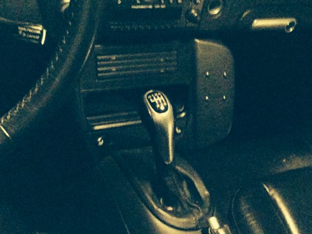

Want to remove phone mount and replace with stock cover plate.
I have a 02C4 Cab. The car has the phone mount option with a piece that is attached on the passenger side of the tray/CD holder. It makes a few too many squeaks and rattles and I'd like to remove and replace with whatever the stock cover plate that would go in that area instead.

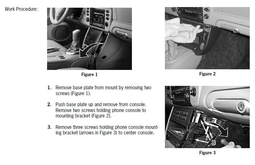

Here are the directions to remove the cell phone holder.
