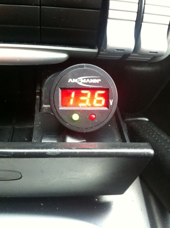

Because i didnt know what they did with the battery, i changed the old one
For a almost new one from my garage which i loaded before .
This time the meter is showing higher numbers.
My question, is it possible to drive the car in this condition?
Reading from meter in details:
Engine off 12 .50
Engine running 11.9
Driving 13.6
Engine off 12 .50
Engine running 11.9
Driving 13.6
If the voltage is 13.5v or above when driving, it should be fine to drive the vehicle. Don't leave it out of the garage overnight though since you may have a drain somewhere that hasn't been debugged.

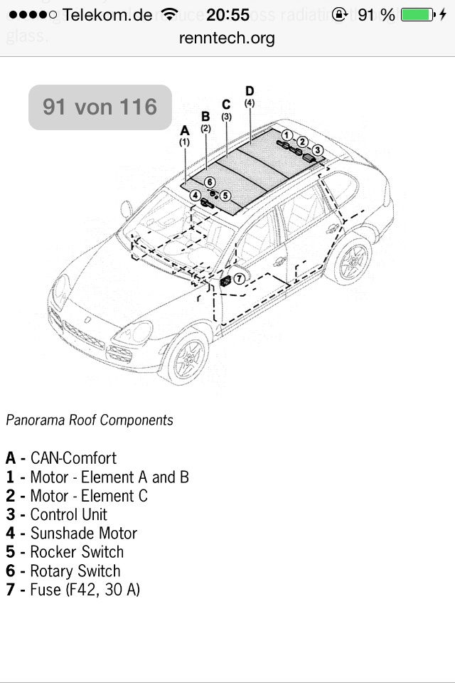

A question to the experts here......
Because my voltage problem came some days
After the panorama roof was fixed, is it possible
There could be a connection between these two things?
I asked because i just read some pages of the self study guide
and see there are maybe some relavant parts in the roof area!?
post-77547-0-00071200-1400094418_thumb.j
It is possible. You should have the people that are looking at the car now look it over for obvious problems and possibly even disconnect it from the electrical circuit for a day or two to see if there is any change.
