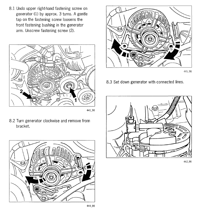

7. Undo right fastening screw (with deflection roller) by three turns. A gentle tap on the fastening screw loosens the threaded bushing in the generator arm (use aluminum mandrel). Unscrew fastening screw and remove with deflection roller.
8. The generator must be turned clockwise so that the swivel arm is near the crankcase and the holding arm projects beyond the fastening eye.
Yea I seen this but Im so confused on what its needing me to do? Which bolt is it in the diagram? Is it the one on the far right with the roller for the serpentine belt?
