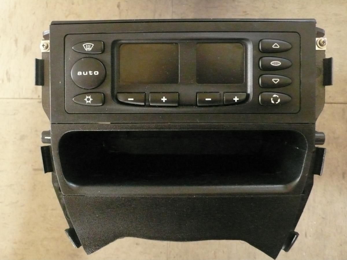

Here's my relocated a/c panel and my batwing filler panel that I made. I had bought the black plastic on line that is for control panels, etc. I might offer a word of warning, the plastic that I got had a very heavy texture, was not compatible with the factory finishing. To save the piece I wet sanded the filler piece and sprayed it with some textured paint. So if you're buying plastic to make surrounds, etc. be sure you know what the finish is on the plastic.

Here's my relocated a/c control panel and my batwing filler panel that I made. I had bought the black plastic on line that is for control panels, etc. I might offer a word of warning, the plastic that I got had a very heavy texture, was not compatible with the factory finishing. To save the piece I wet sanded the filler piece and sprayed it with some textured paint. So if you're buying plastic to make surrounds, etc. be sure you know what the finish is on the plastic.

The batwing is 996.552.335.00.01C ... 12 bucks from Pelican Parts. I'm actually looking into going the other way -- I bought an extra batwing because I want to install aftermarket seat heaters before next winter.
