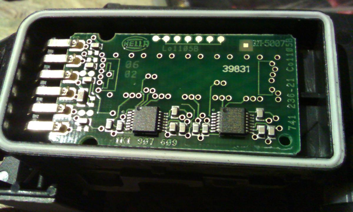

Im searching for the pin out of a 997 accelerator pedal. I tried to measure the resistance between the pins, but I did not have a success, all are high ohmic.
One possibility could be that the throttle is a hall effect throttle and not a classic poti.
Does anybody have information about it for me?

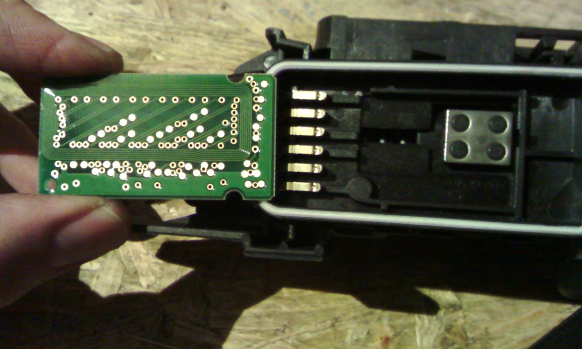

The slider moves over the pcb on the backside.
So this results in an increased number of turns or a decrease of number of turns.
So this could mean a higher or lower restance, but the slider looks like graphit but it does not carry current, it has a high ohmic resistance.
So the other idea could be it is magnetic, but it isn't.
post-95239-0-81887900-1400098047_thumb.j

Hi, I want to use the pedal in a 996 to control an inverter. The car will be converted to be electric.
But I need to build a electronic to go with the signal from the accelerator pedal to the controller.
It would be nice to know how it works and which of the pins are for power supply and how the signal looks like which comes out.

I think about the best you are going to find is just a wiring diagram, Porsche has never been really big on publishing "how it works" for any of their components, particularly their electronics.
in parallel I tried to fine one from the 997 but the only one I can find is from the 996. Maybe I have to search for a longer period, but if anyone would have one it would be very nice to get it. The 997 pedal fit's very good into the position of the 997. That's the reason why I want to go for it.
