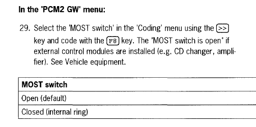

Yes PCM and with or without air conditioning are part of MOST programming.
And you may need to set the MOST switch to "open" (per step 29 of the programming.
Thanks Loren.  My guess is that MOST programming is something only available with dealer specific tools (PIWIS, etc) or is that something that can be accessed by a shade tree mechanic  Calling myself a mechanic, shade tree or not is being generous!; mechanical tinkerer is probably more accurate, but I do enjoy working through issues like these.  Thanks again for everyone's help.
