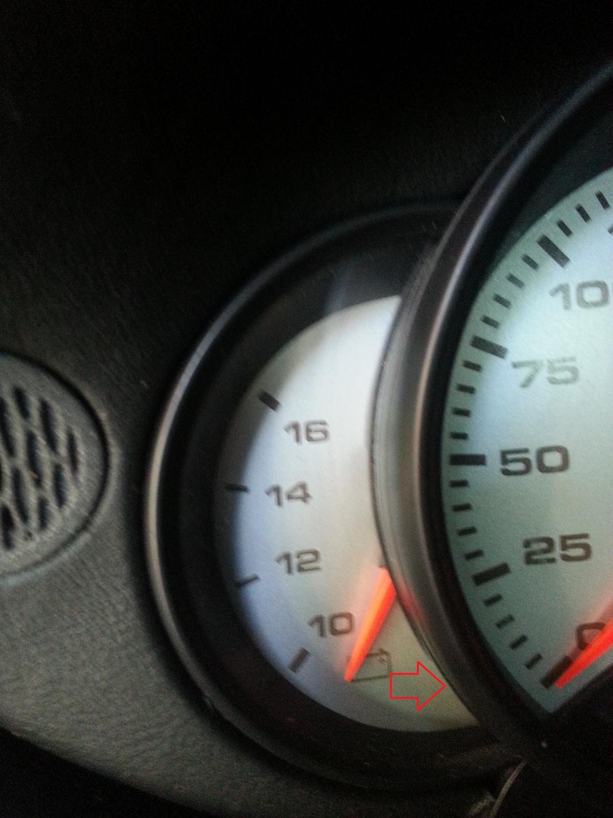

The battery gauge in my 996 MY99 6 speeds won't just shows close to 11 v. Checked the battery while the car was off and shows 12.70+ v. Checked battery in idle and it shows 14 + v. So, the battery is OK as well as the charging system. What could be wrong?

The dash gauges in these cars are not known for their accuracy, so I would not be overly concerned.  Swapping out the cluster requires buying a new one (read $$$$) and having the system programed to the correct mileage using a PST II or PIWIS.
I saw your car in the Registry photos and that gauge cluster is white - so either that was ordered as an option or someone changed the faces.
If they changed the faces then there is a chance that they did not get that voltage needle back on in the correct position.
The fix would require removing the cluster - opening it up and re-setting the needle position. A bit of a delicate job... but it can be done - and it might be a bit of trial and error to get it correct with the actual voltage.
The mileage is stored in the cluster and can only be increased, and not decreased, by reprogramming the cluster, at least not in an OPC. The replacement cluster must have a lower number of miles  than the Original, must also be of the same type. The gauge can also be individually replaced if defective, if it was me, i would start to test the wiring/connectors for excessive resistance first.

PS: I also agree with RFM i would start to test the wiring/connectors for excessive resistance first.

I would also have to agree with Loren in that if someone has replaced the gauge faces, that could be the source of the inaccuracy.

Will start checking the connections since I took the cluster apart to replace all of the cluster bulbs. The battery gauge was working fine before the bulbs were replaced. Also forgot to mention that the battery needle gauge was inside the divider of the other gauge, see arrow. I took it apart in order for the needle to show.
The sticker with the codes in my car shows code X34. Would that explain the white gauge dials?

X34 is the "painted instrument panel", which may have included the dials.
