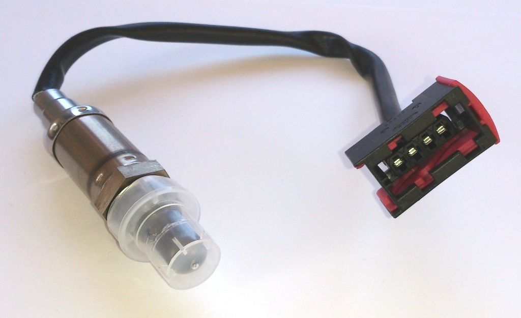

So I now need a new C02 (Lamba )sensor but I can't seem to find the OEM one with the same connectors as mine, any ideas??
The only numbers I can see on the sensor are ; 1-967 059-1 & 1985 299-1.
The one below I found on Ebay is what I need but is not an OEM part. Should I use it??
Question; Does it matter what the Exhaust end of the looks like eg; some of the sensor ends seem to be different shapes ect?
