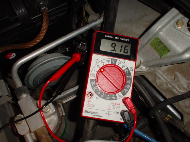

You got me curious so I hooked up my digital volt meter to the alarm horn connector. This is a January 1997 Boxster. I had the meter connected for all 3 tests.
(1) With the alarm not set there was a constant 9.1 volts. No key in the ignition. I am suprised. I do not know why there would be voltage present if the alarm is not going off. So your car is the same as mine.
(2) I then set the alarm, confirmed it was set by the blinking red dash light, and voltage was 8.9.
(3) Then I opened the inside door to set the alarm off, which I could tell by the blinking head/tail lights. Voltage was pulsing between 11.1 - 9.5 in sync with the flashing lights. No horn beeping because I removed the conector for this test.
You must have a bad horn so replace it. Either that will solve the problem or you are going to have a noisy car if the false alarms continue.
I wish I knew if a bad horn is related to "false" alarms, as if the flashing lights are to let you know that the horn does not work. The Boxster owner did not tell me if he was getting false alarms when his horn went bad. But then, I did not ask how he knew the horn was bad.

The 9 volts is just an open-circuit 'floating' voltage that is a symptom of how the alarm horn is controlled by the alarm unit. The 9V is shunted by the horn when it is connected. (Horns are surprisingly heavy current consumers and therefore quite a low resistance)
