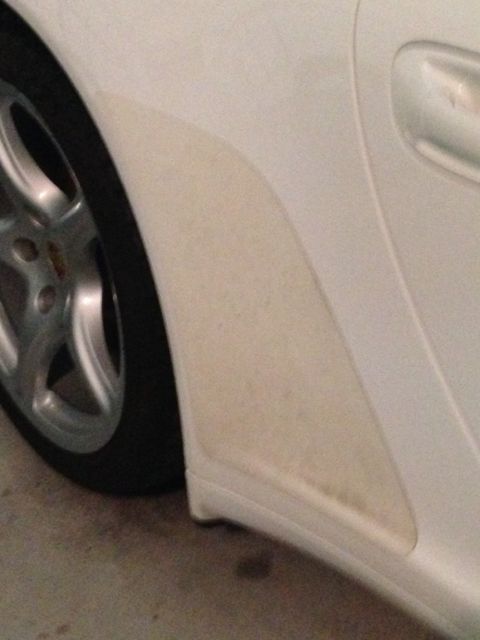

So I'm not even sure what this is called - see pic - but over the years they have become stained and I'm wondering what exactly they do, if they can be removed easily and how and if so will there be a noticeable difference in the underlying paint or should i just replace them with new ones?

These things must protect the bodywork from stone chips, they discolor after a few years, especially on a white background. Replacing them is the best option, removal is not that easy because parts of the paint can be torn off especially if that spot has ever been repainted after repair, carefully using a hair dryer to warm up the sticker first. Caution is adviced here.

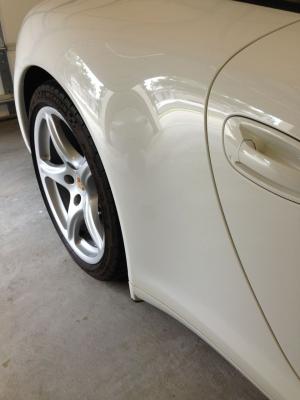

Thanks for the part numbers and the tips!  I used a heat gun and while they did not come off in 1 piece, each one tore about 3-4 times.  Each side had about 1/4 the size of a pencil eraser head worth of glue stuck on the car - coincidently where I started the pull on each one.  Cleaned the area up with alcohol/water mixture.  The whole process took 1/2hr.

Loren & j - I haven't decided to replace so I don't know re: instructions. Have read online to use a mixture of water with a smidge of dish soap sprayed on the back of the new overlay and get it in place then squeegee the water out. If I do replace, maybe a colored one vs clear?? Mine yellowed pretty quickly and have been living with it for years now. Can't get over how much better the car looks without them. Thinking about A new set of Fuchs wheels too but I'm trying to figure out the best way to see how the car will look with them.
