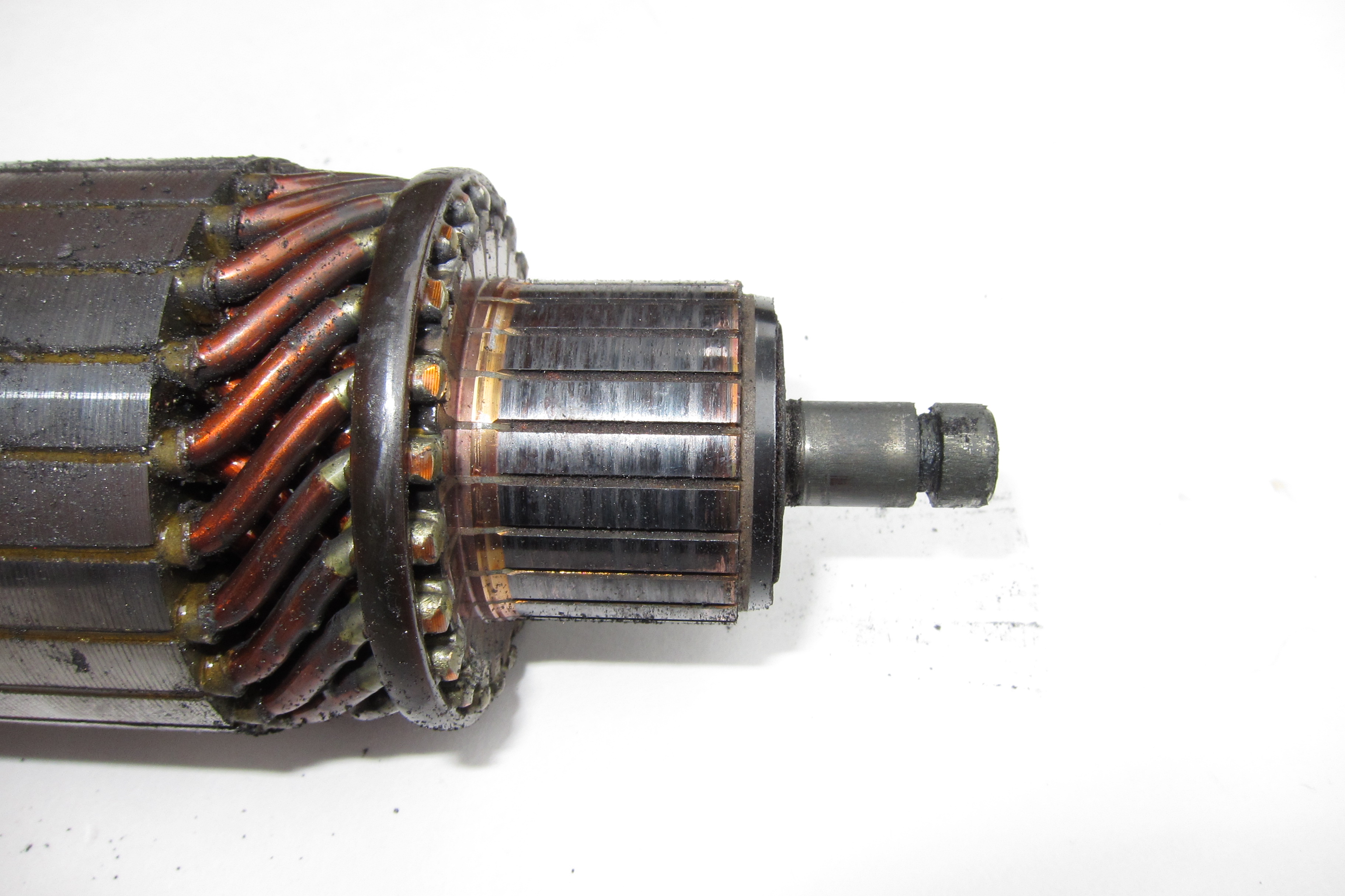

BUT this is what I found when I removed the starter and disassembled it. Just look at the commutators...first pic before, second pic after I cleaned up the starter armature and cleaned up the commutators.
More info here: Porsche 997 Starter
