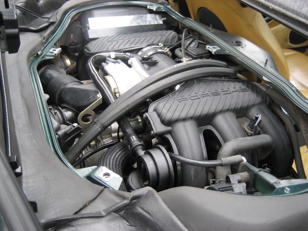

I did locate a few other issues that I'll have to address at some point, but for now i'll just enjoy the car and use it:
1) Small drip from the bottom of the case where it joins the gearbox- I guess this will be the seal on that often suspect IMS bearing? Bit damp on that specific piece of the case and a few drips each day.
2) I also found a small rubber o-ring just below the alternator, around 10mm width. The O-ring is the Same as the one fitted to the unit i removed which is on the bracket above the alternator. I'm going to check that this bracket/unit item (sorry im not sure of its name at the moment) should have 1 or 2 O-rings, but i think 1 O-ring would be fitted as i dont think Porsche would fit 2! I'll check the part in the parts diagram.  This other o-ring migh have just been dropped from a previous owner/job.
3) The 4 jubilee clips which secure the throttle body to the "Porsche" inlet manifolds  (2 each side) were pretty greasy/gunky at the bottom, really dirty and grimy. So I cleaned these up with some white spirit. Might just be a build up of years of crap and dust, with a bit of seeping of fuel. But something to watch out for now its clean.
Otherwise the engine was just dirty so I've cleaned what I could reach.

***Ahsai --- That green connector on the right side of the engine, is just a cover for spade connectors. The wire looks pretty new and goes onto the pump on the right side of the engine, the pump below the hydraulic oil reservoir. The wire goes right behind the actual pulley part. Not sure if its the  aircon or power steering pump.

It sounds like the small drip may be a leak in the rear main seal ( RMS).  Not sure how many miles you have but to get to the RMS you have to drop the transmission and it's best to do several maintenance items like clutch, check flywheel, IMS etc. The cost of the labor to get to these items (9-10 hours) is a big consideration and is why it is best to take care of as many items as possible when the tranny is dropped.  If the little drip gets worse, oil saturating your clutch pressure plate is a real possibility. If your MY00 has 100K-KM (60K miles) or more it's probably time.
1) The drip is not good. Like Kbrandsma said, it could be RMS. However, it could also be the IMS, Either way, you need to drop the transmission to find out. Note s leaking IMS can also be a precursor of IMSB failure.
2) Probably just an old o-ring from previous install
3) That's not uncommon. Usually the AOS cannot clean up the oil vapor 100% so the residual will be accumulated at the bottom of the intake plenum and then leak out to the rubber sleeves.
