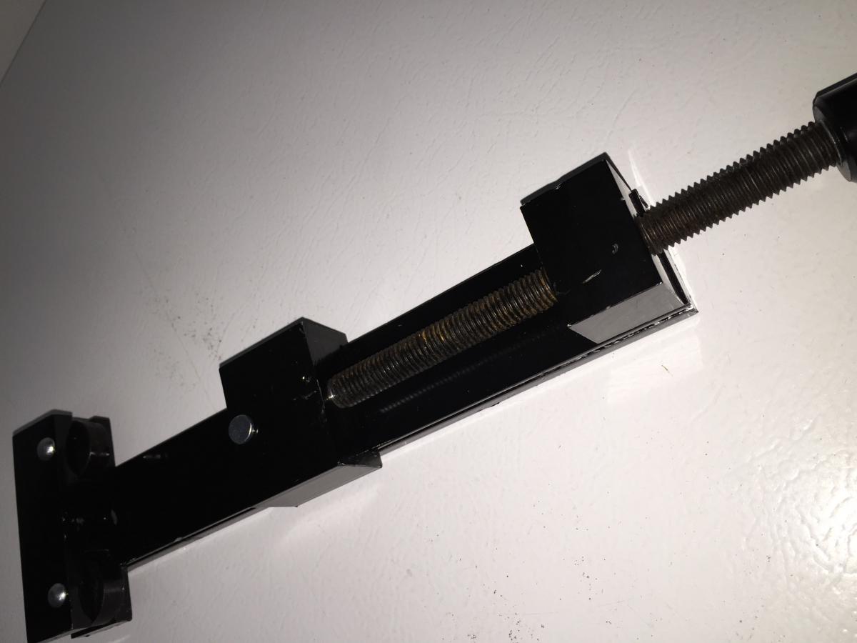

So today I had my first chance to use my new sniffy oil filter cutter (amazon.com) on an accumulated collection of used oil filters from the car...

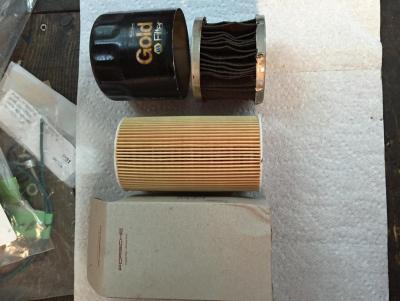

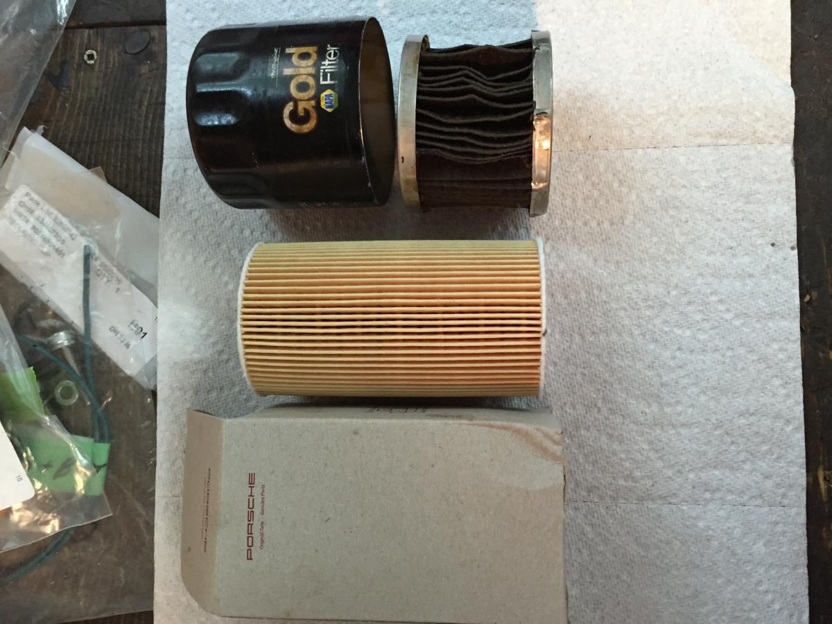

The more oil filters I cut open and examined for metal particles (fortunately none found), the more I questioned the use of a filter with such small filtering area. And, quite frankly, I see little difference in the filter paper material used in the recommended NAPA Gold filter and the Porsche cartridge....
post-80157-0-51541800-1442858555_thumb.j
My layman' reasoning concludes that it's easier to push he same amount of oil thru the larger Porsche cartridge filter, and, certainly the filter would be cleaning inch for inch through the same cycle. So, is the oil filter adapter gizmo all hype? Thoughts?

Easy: While the OEM filter is much larger in physical size, it is also much coarser in terms of the filter media pore diameter as well, which allows a lot more fine material through the filter and back into your engine.  The NAPA Gold spin on has nearly a third smaller pore diameter in its media, which stops particulates that would pass through the OEM filter.  And as Ahsai has also already mentioned, the spin on is a "full flow" design, which does not have a bypass like the OEM filter, so all the oil is filtered all the time, and failed bypass valves are a real issue with the OEM setup.
As for physical size or surface area, that is not the critical measure of an oil filter, what you should be looking at is efficiency (how many gallons per hour of oil the filter can the filter handle, and how good is it at stopping particulate matter); and in those categories the spin on wins hands down (it is rated well in excess of the volume of oil your engine can actually pump, and with a third smaller media pore diameter it will stop a lot more than the OEM unit).
Some like to argue that without a bypass and with smaller pores, the spin would clog up faster than the OEM and shut off the oil flow in the case of a catastrophic engine failure, which is actually irrelevant as in that case the engine is already toast and would need to come apart anyway, regardless of which filter is on it, and running it longer with circulating debris is just going to make a bad situation a lot worse..
We have a lot of customers running the spin on filters, and we cut open every filter on every oil change, regardless of filter types.  We also offer UOA for every oil change to our customers as well, and many make use of that service with each change so that the owners have records of how their engine's have been doing over time.  Which style filter you use is not a matter of hype, the spin on is better hands down, particularly if you also run a FilterMag unit on the outside of it, which passes every drop of oil in the engine through a strong magnetic field as it passes through the filter.
