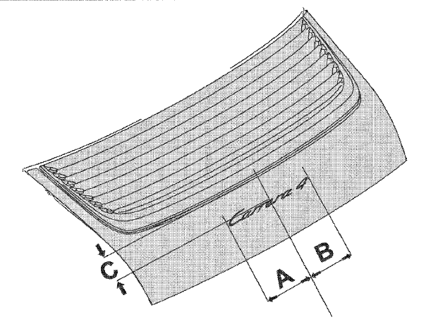

On 2/10/2015 at 10:30 AM, Loren said:
C4 Logo
1. Find the middle of the lid.
2. Position the Carrera logo with the dimensions A and B = 162.6 mm- and C = 35 ±1 mm on the rear lid and affix.
Correct part numbers for silver logos for a MY1999 C4
"Carrera" - 996 559 237 07 4PU
"4" - 996 559 241 01 4PU
Does this logo part# fit my 2001 996 decklid?  996559237104PU

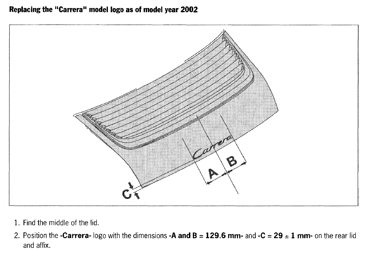

On 4/26/2005 at 1:28 AM, Loren said:
"Carrera" model logo up to model year 2001
2. Position the Carrera logo with the dimensions A and B = 129.6 mm and C = 35 ±1 mm on the rear lid and affix.
This is for the 996 gen 1?
The 996 gen 2 has the logo placed lower on the lid. Does enyona have the measurements for that?
