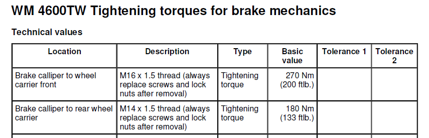

What is correct torque for front and rear calipers on a 2012 Cayenne S with silver calipers which has 360mm up front and 330mm in the rear? I have looked and see specs for the earlier 955 Cayenne and the 2011, but I think something changed in 2012. I see various info, and it looks like maybe it is 200 ft lbs up front and 133 in the rear but that seems high so I was wondering if someone has the repair manual to confirm?

The torques for each caliper in my manual are:
- Front Caliper Bolt Torque for M14x1.5x115: 104 ft-lb
- Rear Caliper Bolt Torque for M12x1.5x115: 63 ft-lb
It seems that there are big difference between S and Base even though they have the same rotor sizes?
(Example) M16 vs M14 (Front) and M14 vs M12 (Rear)
Before I ordered the parts through Suncoast, I double checked the caliper sizes with a rep. If they sent the caliper bolts with wrong sizes, I should return them and replace with the new ones, i.e., M16 & M14.
Any clarification would be highly appreciated.

Regardless of the torques, the bolt sizes are different from what I received from Suncoast. I researched a little more and found that the caliper bolts are all same for 2011-14 Cayenne Base ~ GTS, i.e., M14 & M12 (No M16).
Anyway, I got the torque info from:
WM 4X00IN Tightening torques for front axle
Technical values
No. 3: Threaded connection securing brake caliper to wheel carrier
M14 x 1.5 x 115 thread (always replace screws and lock nuts after removal)
Tightening torque 140 Nm (104 ftlb.)
WM 4X00IN Tightening torques for rear axle
Technical values
M12 x 1.5 x 115 thread (always replace screws and lock nuts after removal)
Tightening torque 85 Nm (63 ftlb.)

I think that I found some more clues.
http://www.pelicanparts.com/cgi-bin/supertech/catalog.cgi?action=frameset&return-url=/cgi-bin/supertech/catalog.cgi%3Faction%3Dframeback%26page%3D1819&catalog-url=http%3A%2F%2Fwww.pelicanparts.com%2Fcatalog%2FSuperCat%2F4898%2FPOR_4898_BRKHYD_pg1.htm%3Futm_source%3DSuperTech%23item2
2010 Cayenne has M16 (front) & M14 (rear) caliper bolts as shown in the above link.
Both M16 & M14 caliper bolts are torqued down to 200 ftlb from the factory.
If the post-factory torque for the rear caliper bolt is 133 ftlb as shown in the table Loren provided, it's about 67 ftlb less than the factory torque.
So we can assume that there is a great amount of tolerance on those parts in terms of torques.
