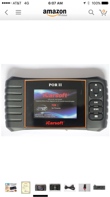

Just to be sure, here is a picture of the one I am using. There is an older version that did not have that full functionality. I wonder if you need to select by can bus type rather than model type. Maybe some years were different. Could also be a faulty ecu but not likely if you do not have an error. As far as durametric I had nothing but problems in that it would not reset anything. That is what led me to icarsoft eventually. If the problem is isolated to the 955 it make take several people questioning so I would encourage TT955MTL to contact support with the same concerns.

The Icarsoft diagnostic tool you seem to use (the one on the picture) is the PORII.  Glad to see it works great for you and hat you can reset service reminders on your 958.  As for the older Icarsoft diag tool, the i960, I don't think it can reset any service reminders.  Mine doesn't or I don't how to use it ;-)
A couple of months back, I contact Icarsoft customers' service about the PORII "service reminders" reset capabilities.  I was told the PORII would reset reminders on 957s and 958s but not on 955s.  If anybody had successfully reset reminders on a 955 with a PORII, please share your experience.
