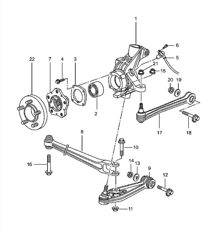

If i go under the car and have someone pressing the rear down i can fell that the squeaky sounds makes vibration in part nr 8 in the pic below.
All the nuts feel tight and from what i can tell nothing is loose.

Along with checking the various suspension arm bushings, I would also check the wheel bearing (item #2 in your diagram), which is a common maintenance item on these cars.  I would also look at the upper strut mount bearings, another squeaking noise generator.
Wheel bearings for me have always been a high pitched whine when driving, sometimes an intermittent squeal. At 130k I would expect most or all of your bushings and ball joints in the rear are probably ready to be replaced. I know mine are at 100k and I am chipping away at them as I can.
We find them often when owners complain of a persistent low rumbling sound as well.

A small update, the rumbling sound (poor choice of word) is not from arm nr 8, its from the arm nr 9.
Just by seeing how its connected i know that im not gonna change that by myself ;)

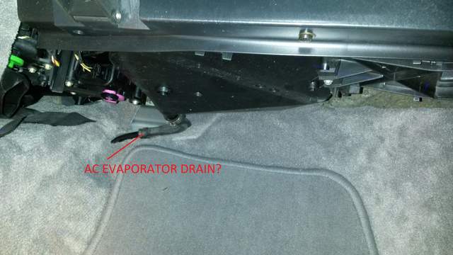

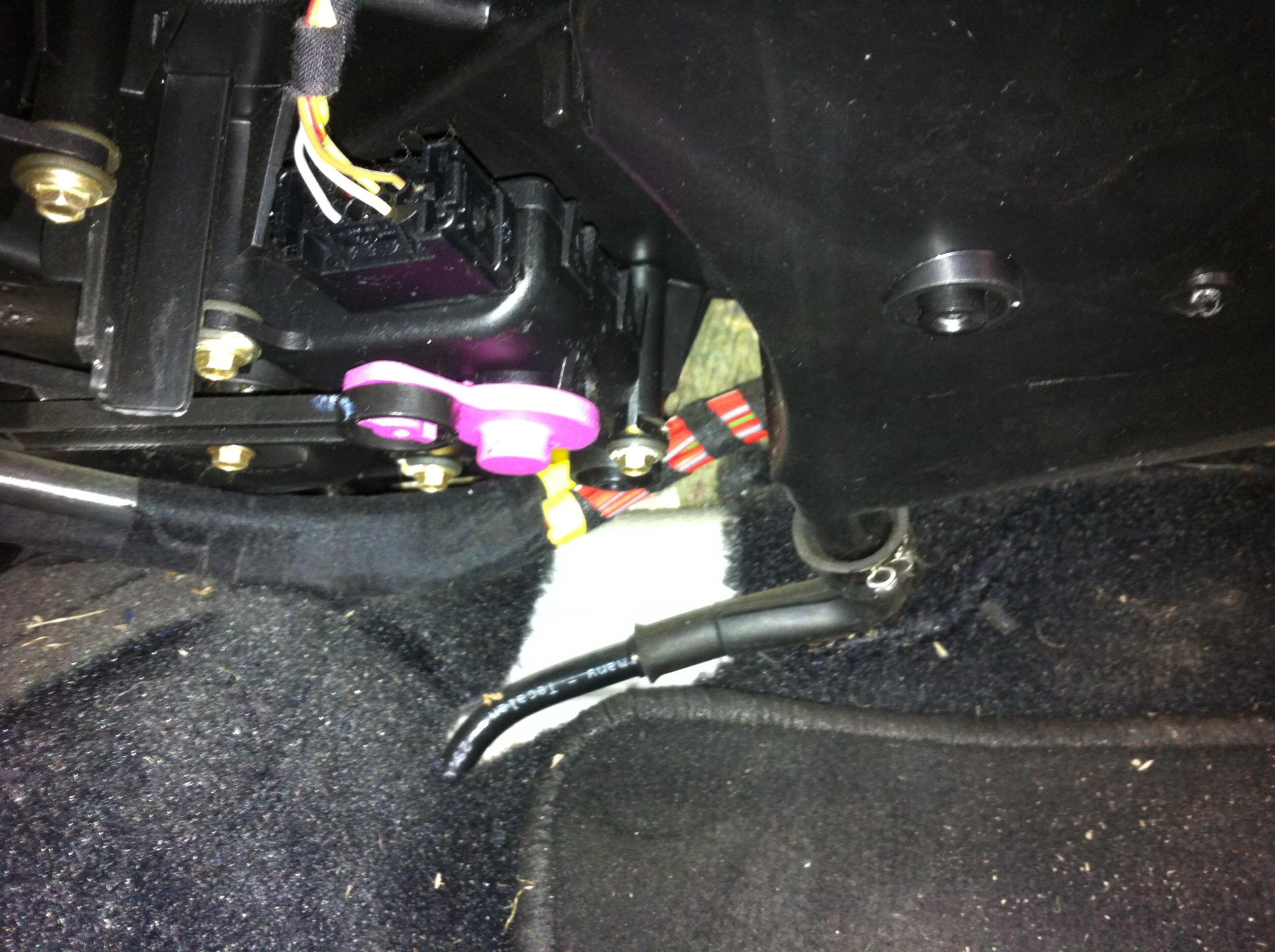

But here you have a pic a at least.
Its the black thing thats has the purple thing on it that makes the noise.
Its located on the left in the passenger fototwell.
I'm trying to visualize where we looking, it that looking up at the bottom of the heater box?
To be honest, im not sure how the heater box looks like :blush:

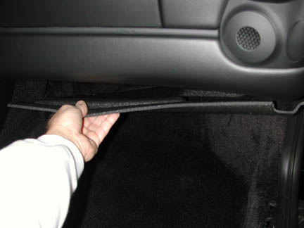

But i found this pic :)
On the upper left you can see the purple/pink thing.
To get there this foam part has to be removed

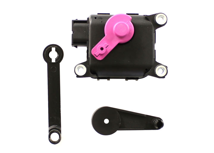

I hope its ok to link to other Porshe pages, this is on a 996 http://www.pelicanparts.com/techarticles/Porsche-996-997-Carrera/103-ELEC-HVAC_Motor/103-ELEC-HVAC_Motor.htm
Pic nr 5 there you see the actuator with nr 99657392100 that sometimes is called green. And 99657391900 that i think is the Purple one.
*edit*
Got it!!
The thing was to do a search on 99657391900 instead of 996-573-91-00 :)
