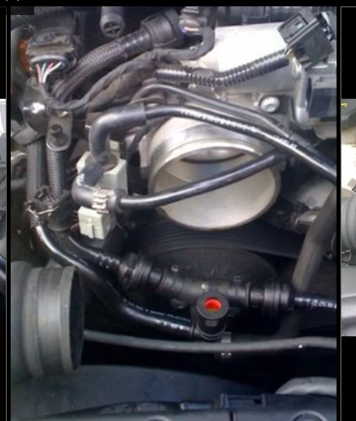

On every Cayenne which i had it was always trouble with
This small connection which is near the intake pipe. On the picture here seen as red.
Is there any possibility to replace it with some aftermarket pressure hose? I have a constant overboost code in my code reader and as hahn pointed out it could be together with some false reading because there is something wrong with the vacuum lines. Any help is welcome.
post-77547-0-34770900-1462705373_thumb.j
In my continuous search to rectify my stutter and splutter running problems at around 2k 3k and 4k RPMs under loads varying in any gear, I also had issues with this fitting. it is a push fit connector which is rubbish, I removed the intake pipe plugged the connector in firmly and then used black PVC tape to wrap it tightly. it doesn't look professional but it doesn't leak and doesn't pop off now.
