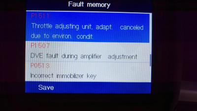

Got home and scanned it:
7 DME faults - key immobilizer, O2 sensors, MAF, TB, DVE.  Codes in attached pics.
1 Transmission Fault - DME 1314
1 PSM fault - DME 1314
From some research it sounds like the first thing I should check is the health of the battery/alternator, correct?

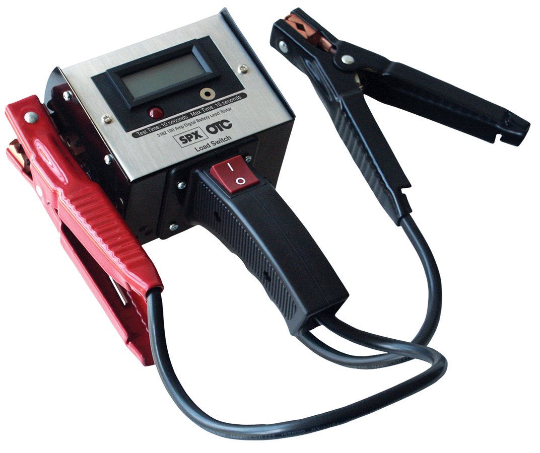

Could be, but I would not be swapping out anything with out testing first.  The correct way to test a battery and alternator is with a load testing device, which puts extreme loading on each while also monitoring how each responds.  The devices themselves are not particularly expensive, and many auto parts stores now have them available for customers to use for free.  This is the one we use in the shop, very quick and accurate testing, and it cost about $75:
This one says its good for 125 amps and I can pick it up tomorrow in store: http://www.northerntool.com/shop/tools/product_200611634_200611634
Google isnt turning up much for testing the alternator with a load tester (it is all multimeter)...how do you do it?
Instructions should come with the unit, but this is the basics: http://www.delcoremy.com/MediaLibraries/DelcoRemy/DelcoRemy/Literature/Troubleshooting/Delco-Remy-Charging-Troubleshooting-Guide-8-13.pdf
