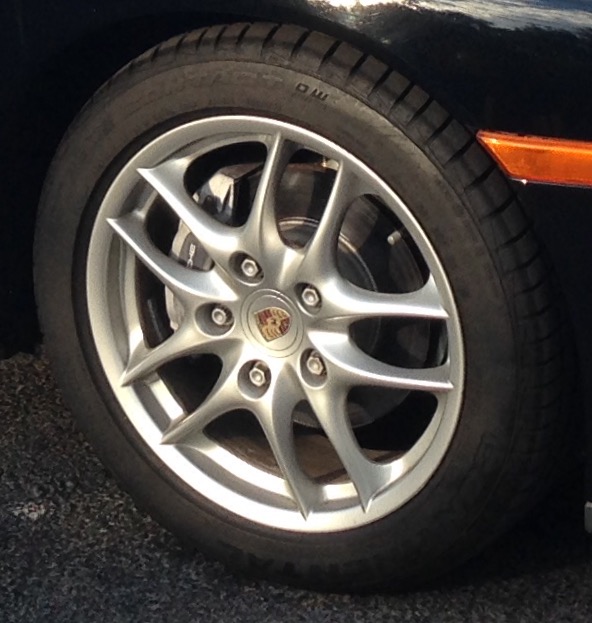

2004 Boxster, 2.7, Tiptronic, 36k miles, 17" wheels.
First off, I love these wheels on this model! It's one of the options I was looking for while shopping for a Boxster. I'd love the wheels on my triple black car even more if they were black also, gloss black. My wheels are in perfect condition, perfect!
I've searched here, PCA forums, other forums, and I can't seem to find info on the longevity of custom painting wheels. OEM wheels have a very durable finish on them.
Is it possible to re-color them with long lasting success? If so, what process is best to employ to paint wheels - unmounted, bare, no tire or valve stem?
Or . . . . should I just wrap them, knowing that re-wrapping is needed periodically, so that I retain the original finish if I sell the car in the future?
. . . . I'd still like to hear about the pros and cons of painting wheels.
Have some of you painted your wheels? Successfully?
If a company, such as the one Loren recommends above, refinishes a wheel, I would assume they strip and paint from scratch. Would this sort of process include baking the new finish (assuming also that Porsche bakes the finish on the wheels)? In other words, are aftermarket finishes the same durability as Porsche factory finishes? The lower valance of the rear bumper on my ST was replaced and the body shop baked the new paint.
I didn't think I'd have time to call Wheel Enhancement until later, but I had a few minutes so I called.
My confidence is very high with this company after speaking with Dave at Wheel Enhancement. My ignorance from my last post has been remedied after a short conversation. They strip the original finish off, and the new finish is baked on. Similar to how Porsche does it.
The center caps are not so successfully refinished, so the recommendation is to get new black centers from Porsche to go along with black painted wheels.
For me, I'm thinking that I should keep my current wheels the way they are. When I'm ready for the black wheels - order during winter for next spring - I'll get on the list for when Wheel Enhancement gets a set of used wheels in stock to have those finished and sent to me. "I like it when a plan comes together".
