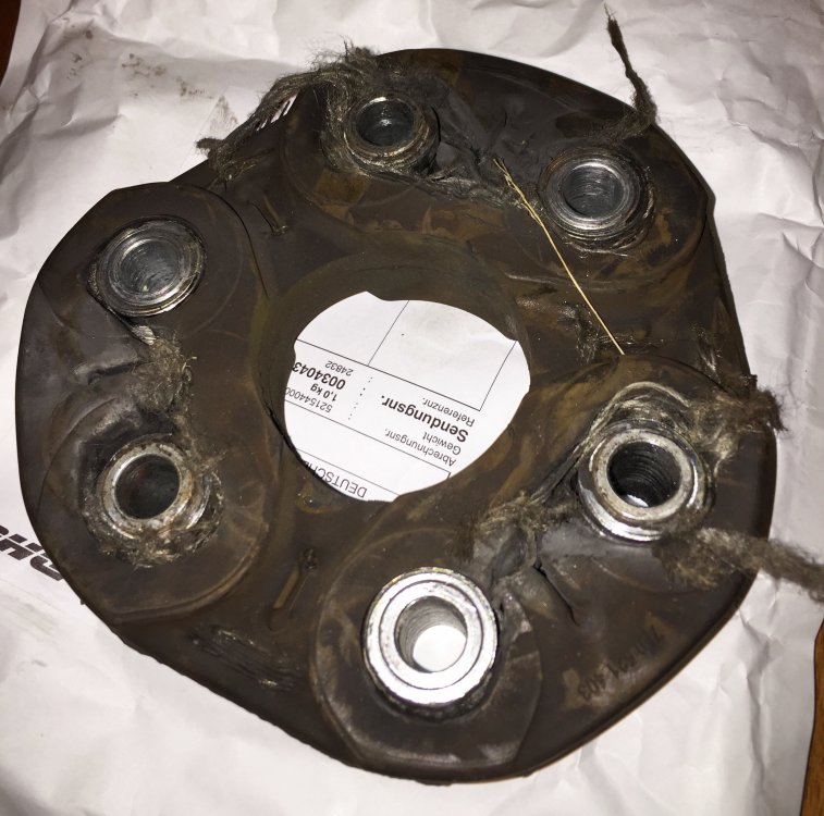

So just a update.
My first long trip after the car came back after flex disc replacement.
Frankfurt to Munich and back.1000 km.
i have to admit, there was no vibration , no hesitation when accelerating. Was all this strange behavior before only related to the cardan flex? Hard to believe.
But for now the car runs pretty well.

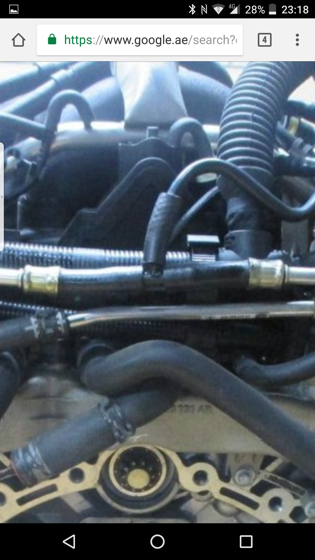

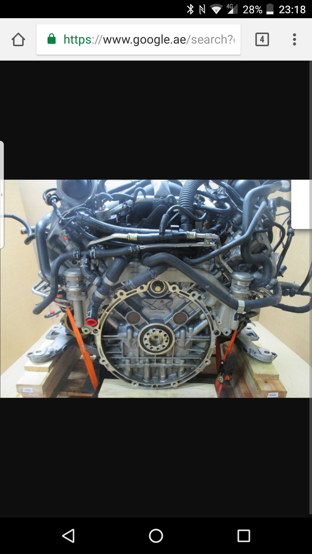

Not just because I miss this thread, but Lewis or Thomas, do you know anything about this vent/valve here? I can suck air out of it but not into it. Since it is a crankcase vent, you would think it would be the other way around...thanks.

Hi Mikel. Hope you are doing well.
the vent hose you are talking about has to be close. Its regulating the pressure within  the crankcase. Crankcase ventilation hose. Any leak will result in a strange engine running. For my understanding if to much pressure the vent is opening and preasure can release .
Share this post
I think Thomas is spot on, it's a fail safe if the crankcase vacuum becomes pressurised it will vent out here.
Share this post
Thanks Thomas, thanks Lewis,
It does takes a bit of pressure to open the valve and let pressure out, so I guess that must be enough to hold it in – I don’t see any oil coming out there so I guess it holds.
But you mentioned the crankcase “vacuum” becoming pressurized; I never new it also becomes negatively pressurized. I thought it was always a PCV system. Interesting; the reason I am looking at any of this is the small line that runs off this hose and goes to the back (looks like into the manifold, maybe that is where the negative pressure comes from) is oily at the connectors, thought it might be leaking a bit. At any rate going to clamp those up just for good measure. Thanks.
The small pipe goes to the rigid metal turbo vent pipes located at the rear of the engine. Mine are leaking oily mess but when it tested it I could get anything to pass so I just left it alone as it a total b * tch to fix.
If the vent system from the turbo fails it might be able to become pressurised maybe this is the purpose for the relief valve. Details and pictures are hard to find on the turbo vents I have searched a lot and found jack all.
Share this post
There's not much to know. The single vent tube coming from the passengers side valve cover pcv connection go's to the tee in the rear. This line is always under pressure except in decel. From the tee each side connects to the turbo scavenge tanks. The turbo scavenge pump sucks/pumps both air and oil and dumps it directly back to the oil pan. Replacing the plastic tee with a metal version should be standard practice for the 955. When you cut the metal crimps off you still have a barb to hold the hose on each metal pipe. If the scavenge tanks didn't have a vent pipe the pump would place the turbo's center cartridge under vacuum, not good. The 955 needs an external AOS, or catch can at minimum because the PCV system is terrible and geared towards low maintainence and emissions.

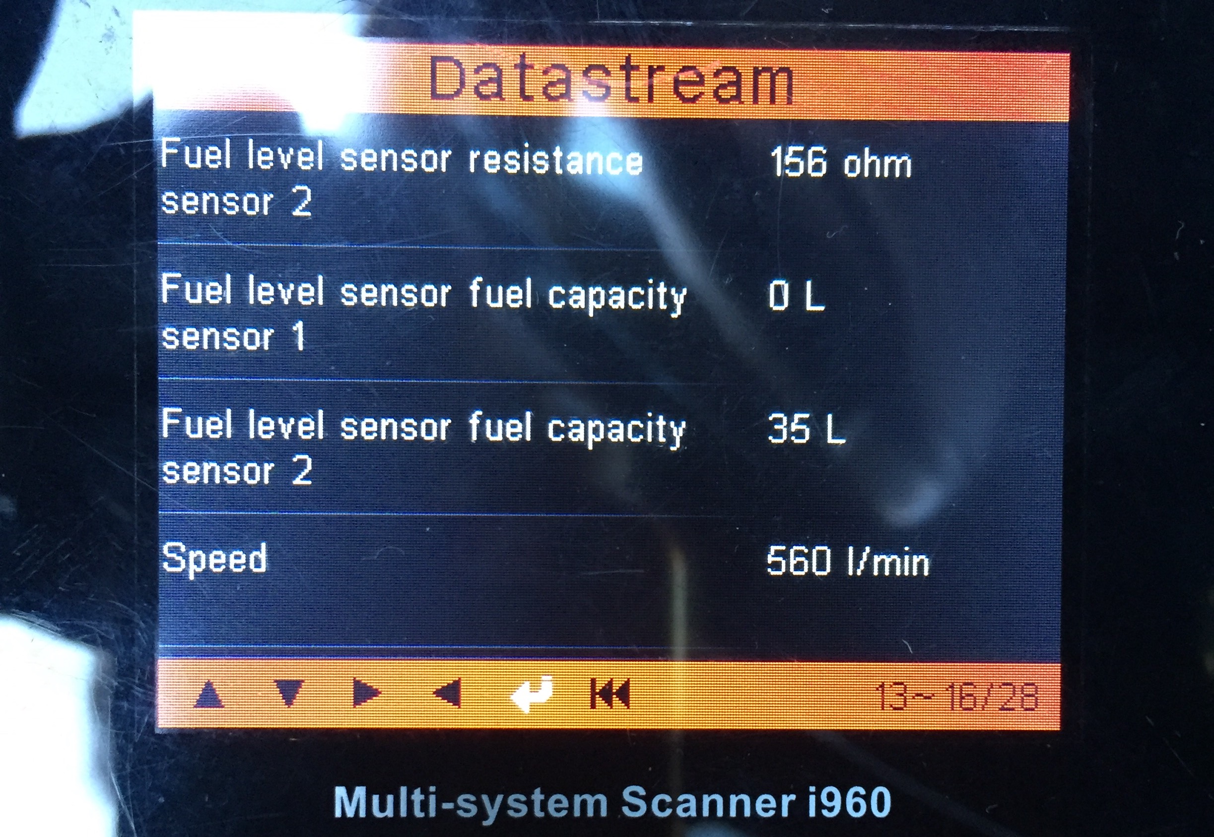

Regarding the fuel pump checking i would like to ask if somebody can read the numbers below and maybe point me to something what isnt correct. Thank you

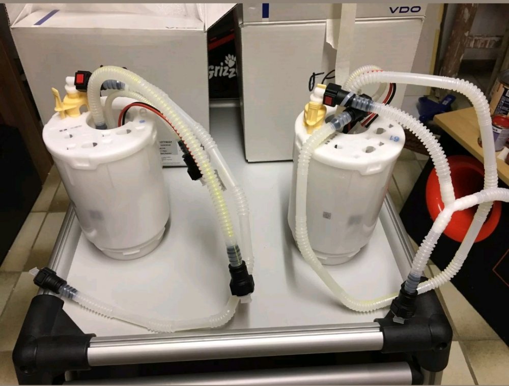

Onother Project starting soon. 2 new fuel pumps. Got it for a really very good price. I dont know yet if am brave enough to do it by myself.
