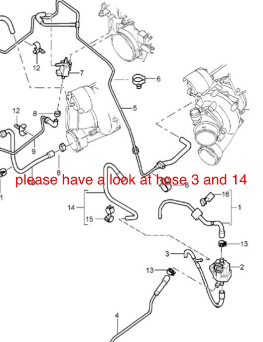

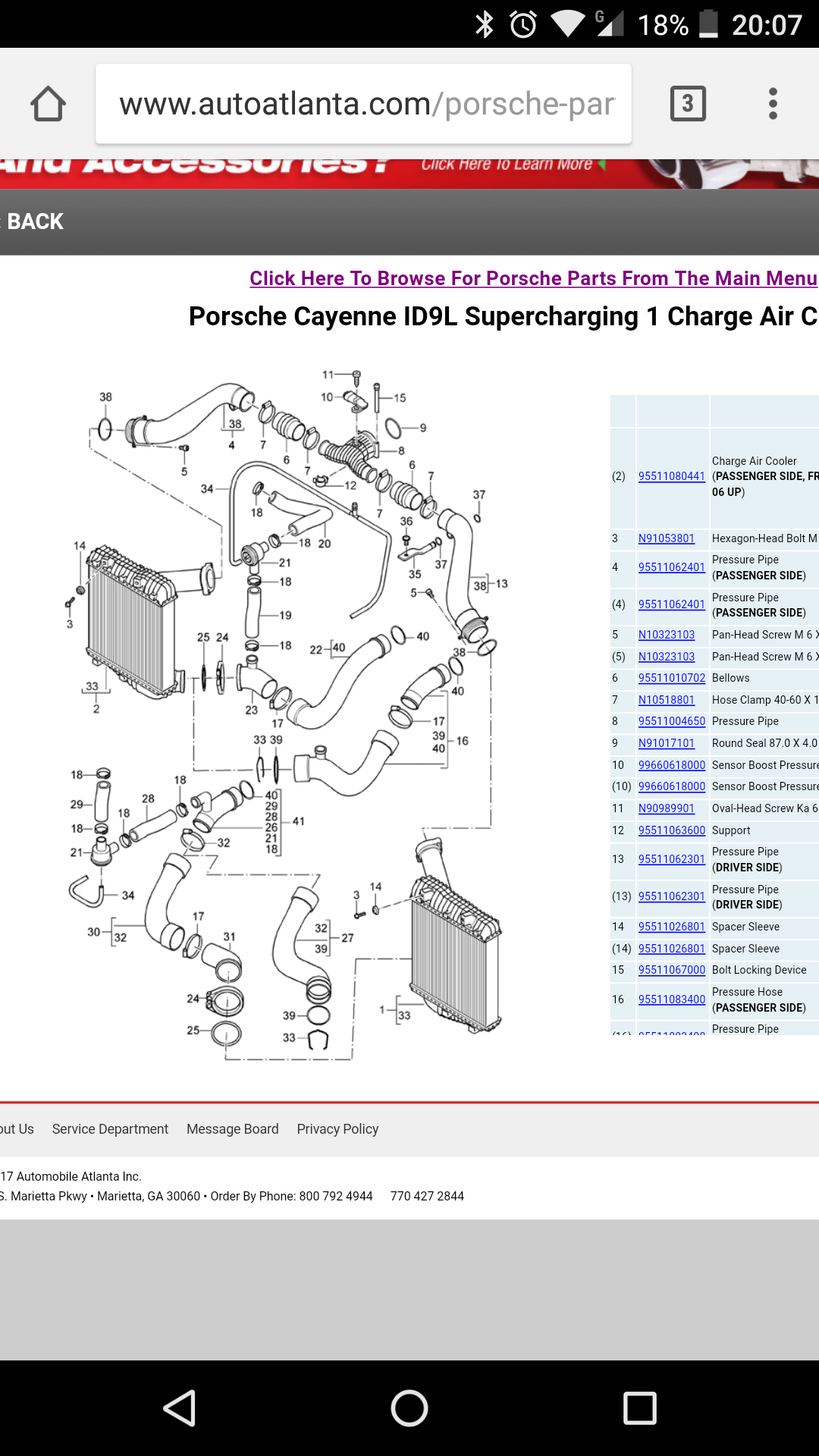

Please would somebody explain me the routing of of the pressure lines close to the firewall.
Line 3 & 14 are connected with each other. Coming from the calve. But line 14 has a dead end. Can somebody explain the reason? Thank you
Share this post
It is a capped off point to connect vacuum tester pump. If you are doing checking for leaks this is where to connect.

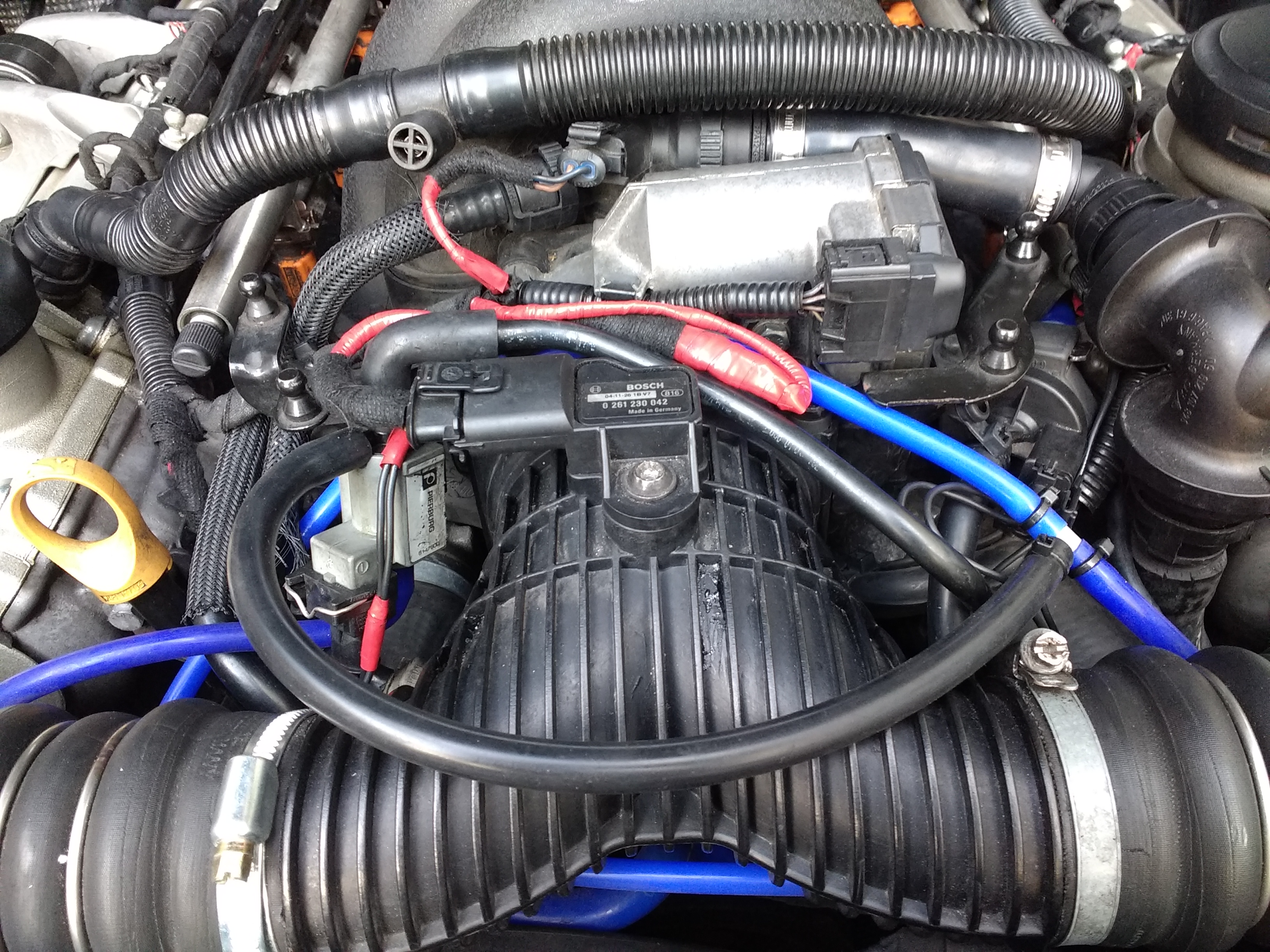

The only thing I can add is check the gasket between the Y-pipe and the throttle. Mine looked OK-ish, but when I put a thin wrap of Teflon tape around the throttle side before putting it together the engine ran better (smoother idle, less dip when coming back to idle) and then ran worse when I took it off. Ordered a new gasket that will come in with my water pump. Also that plastic fitting at the bottom of the Y-pipe right under the MAP is prone to leaking on mine.

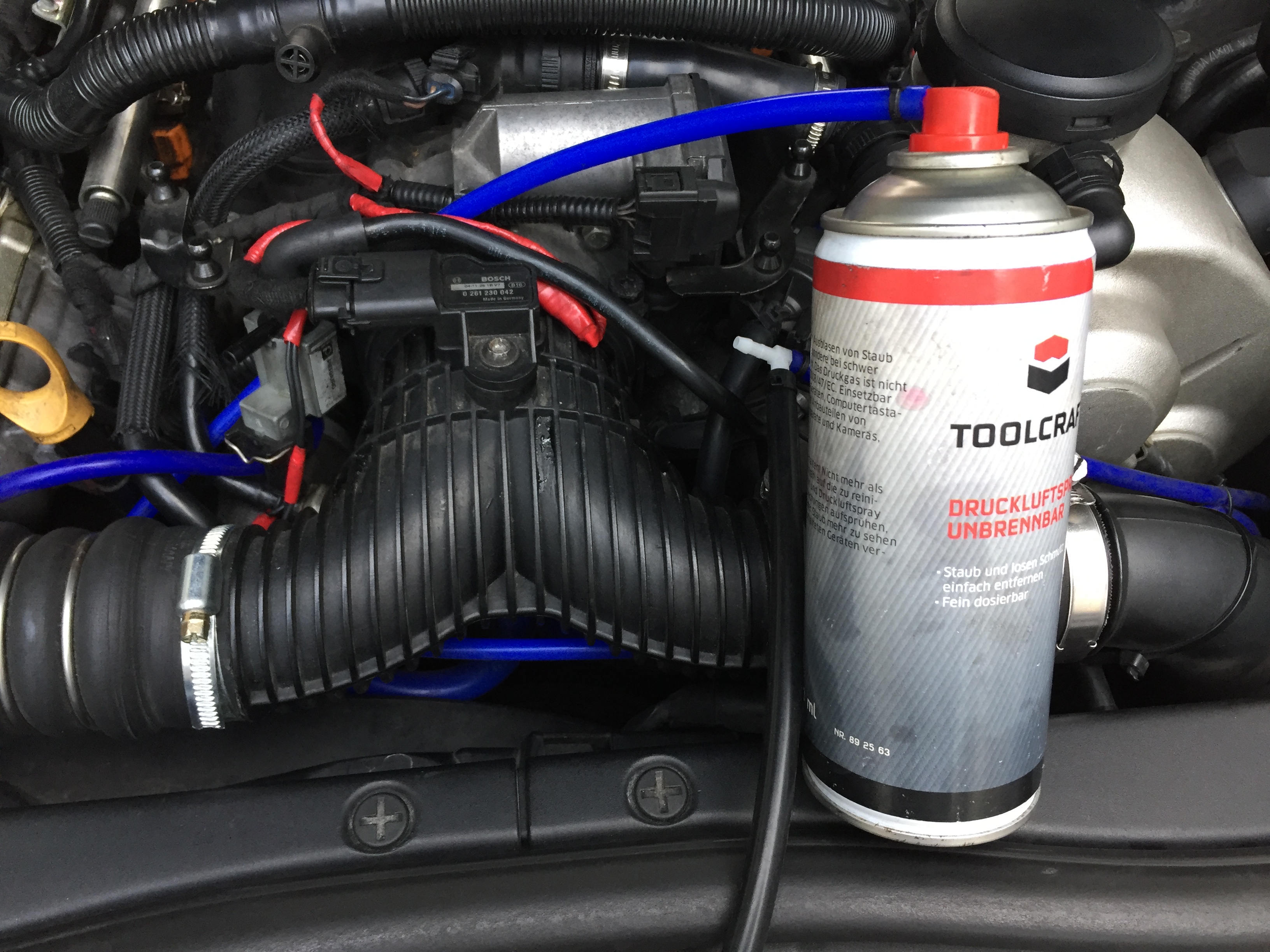

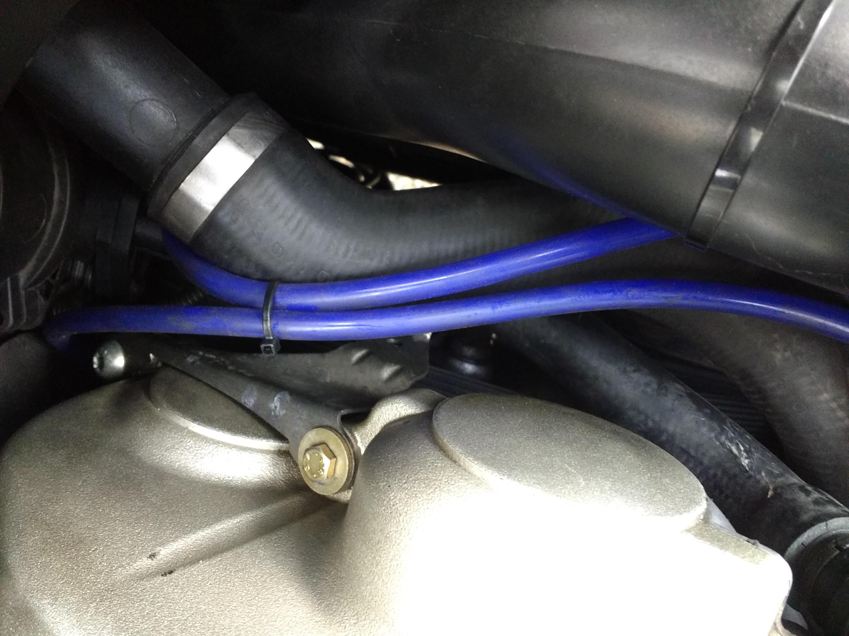

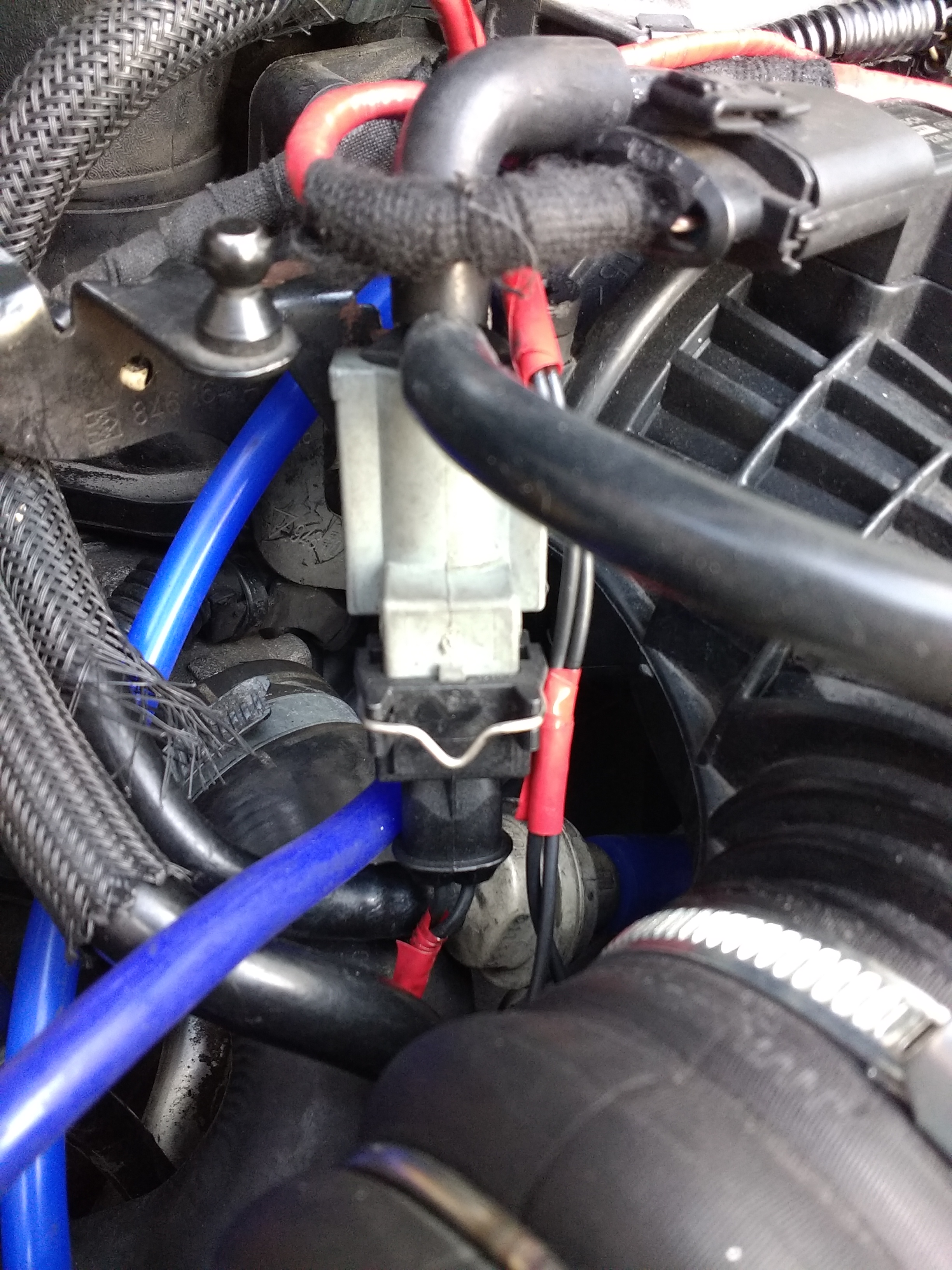

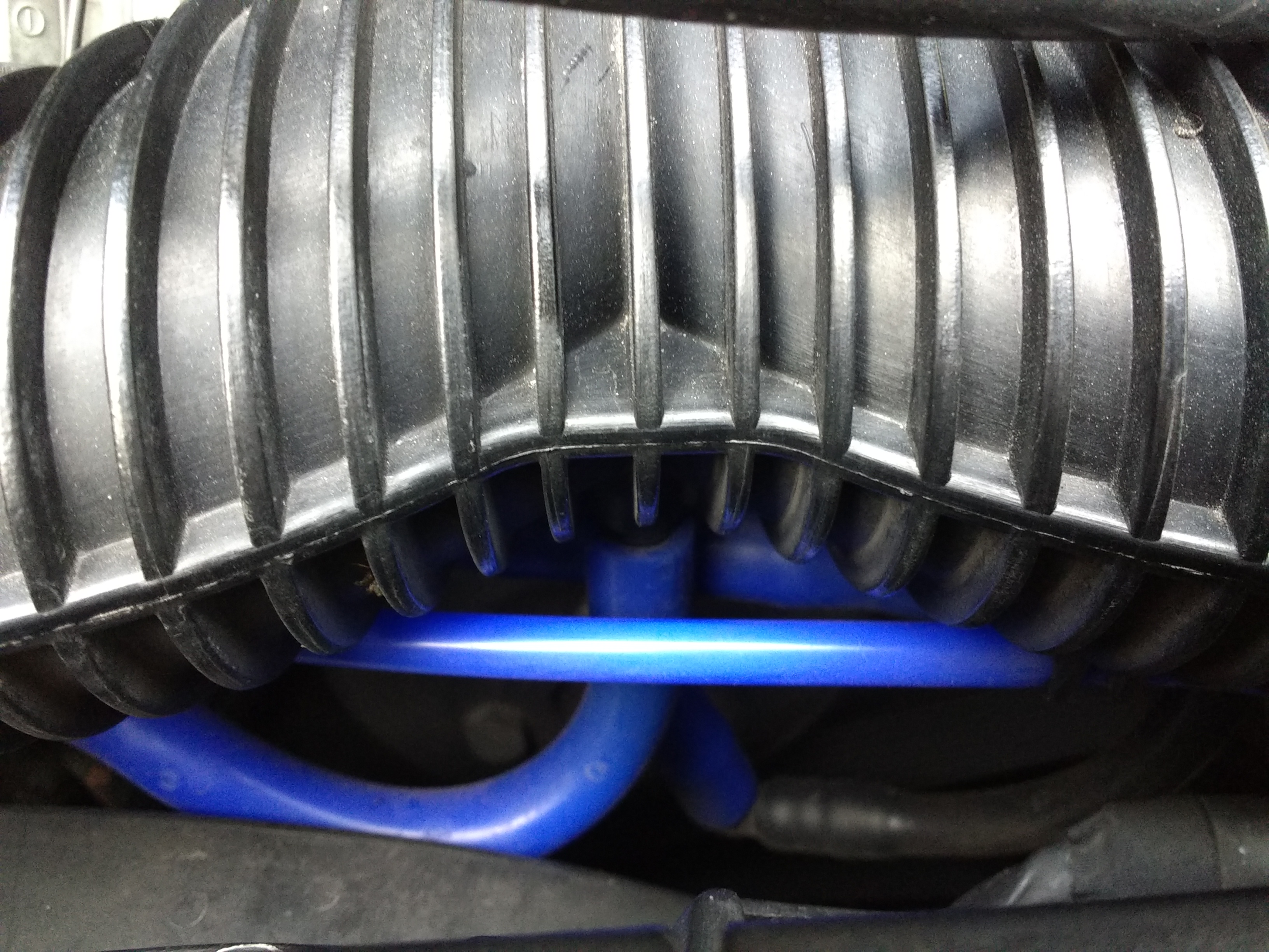

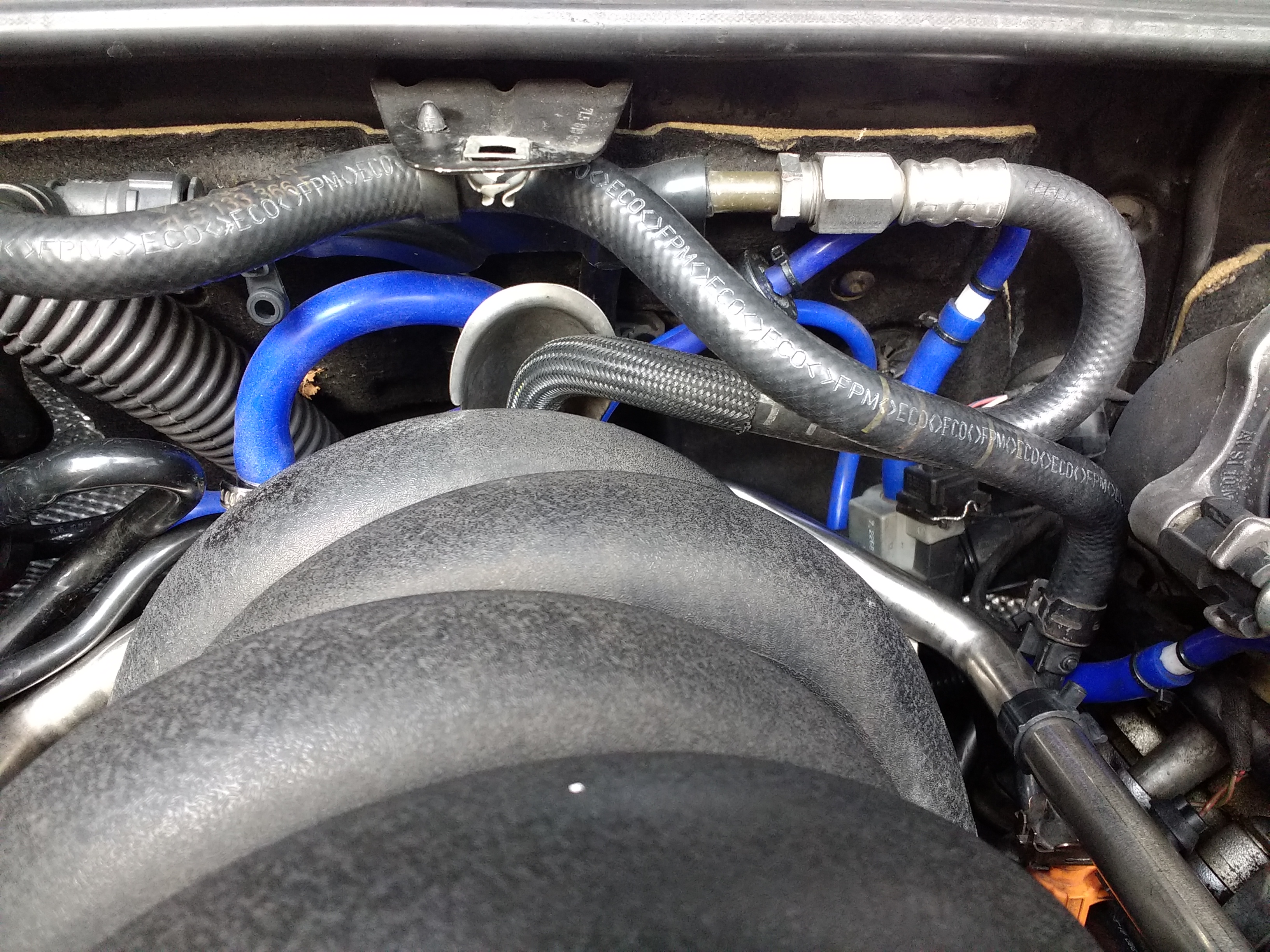

@Zakowsky thank you mike.
the throttle body gasket is also new :-)

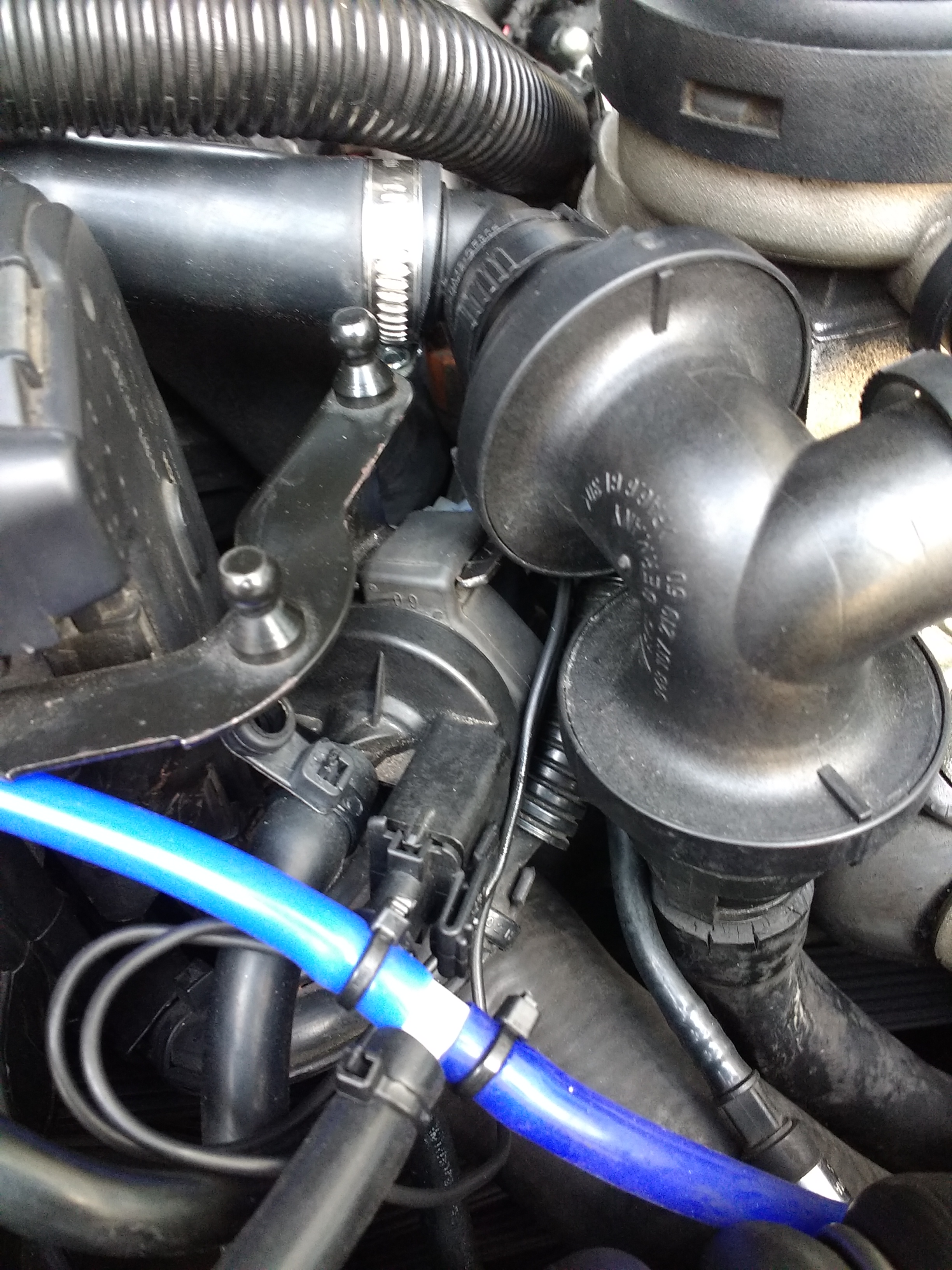

the plastic fitting down to the y pipe i replaced with a pure blue pressure hose. I was cutting out the sensitive connection and replaced it. Very easy to install and very easy to get off. See blue line in the last picture.
by the way, the tube is going to the firewall and is connected in the same way to the intake manifold. This connection i replaced in the same way as you maybe can see in picture no. 8.

Before weekend I would like to ask professional advise. My technical knowledge is limited but I have the strong will to fix the problem.
Because the current overboost problem appeared after I started the search for my oil and hesitation problem I am going back to every part I have touched in the last 12 month. For this reason I would like to ask what will be the result of the turbo vent line has a leak. What will happen? Will it effect idle? Running conditions in general? Boost? I appreciate your help.
I am talking about 14 and 15. Please don't care about the coloured section.
Thank you very much
