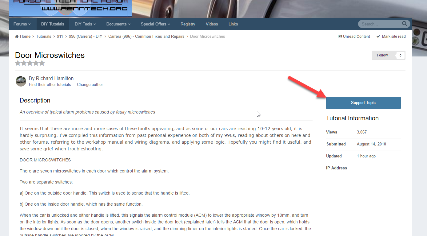

Richard, That link closes the thread. It's all the info anybody could want to diagnose the issue. I'll try to check every switch and resolder the joints. if that fails I'll buy a go to an indy to detect the actual part to replace.
Technically no it is not closed - there is a separate support topic for each DIY.
Just click on the button...
