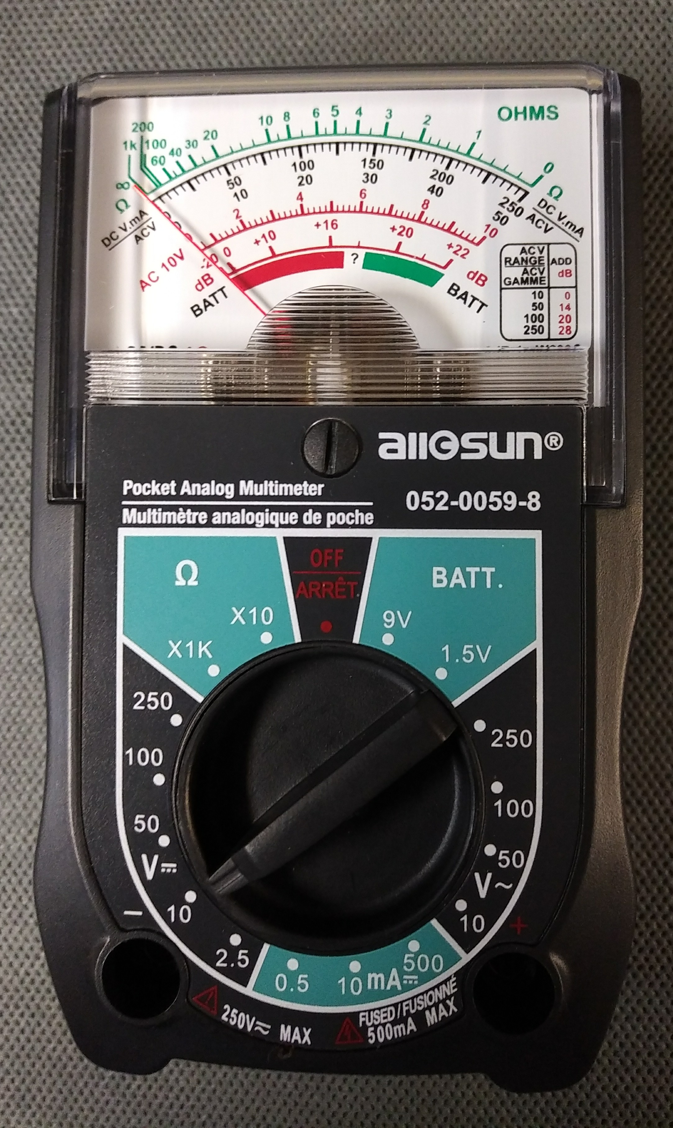

Is your voltmeter accurate? I don't think you can get 13v with the engine off. If it's accurate 15 and 16v are way above the proper charging voltage (13.5-14.5v).

You need to set it to a range that is larger than the expected measurement. DC like Loren said. In this case it's 50v. Is it a digital meter? We also need the first decimal reading. E.g., 12.1v vs 12.7v makes a huge difference. A photo of the meter dial might help.
Wow, reminds me of what I used for my childhood electronic projects :)
Sorry to say but this meter won't be accurate enough for this diagnostic purpose. Digital meters are very accurate and affordable these days. This one is nice because it can measure voltage and current drain by clamping the meter around the battery cables. No need to disconnect any circuits.

So when the car is off it's measuring 12.77....with engine running it's fluctuating between 15.24 and 15.68.  Then with lights on it's fluctuating from 14.98 and 16.04.  It wouldn't hold a steady number.  Thoughts?
