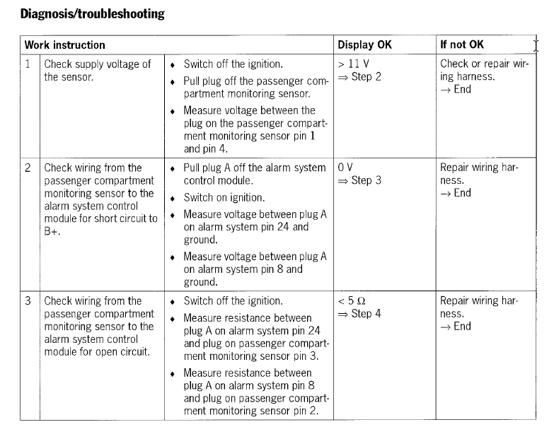

Short circuit to B+
You need no shorts in the alarm, door locks, and windows for them all to work - and you do have a fault. They all run through the same control unit.
You also need a good battery.
3 hours ago, Loren said:
Short circuit to B+
Any tips on how to troubleshoot this? I'm not sure where to start.
Thanks,
Avi
2 hours ago, Loren said:
You are the man, thanks! So I started pulling things apart to see what's going on. So far, I am seeing 12v for the first test, will continue forward now. Just thought you guys would want to see this, I don't think it is normal looking, I'm guessing this is my issue.34odbie.jpgnyfxpl.jpgrh7sly.jpg
