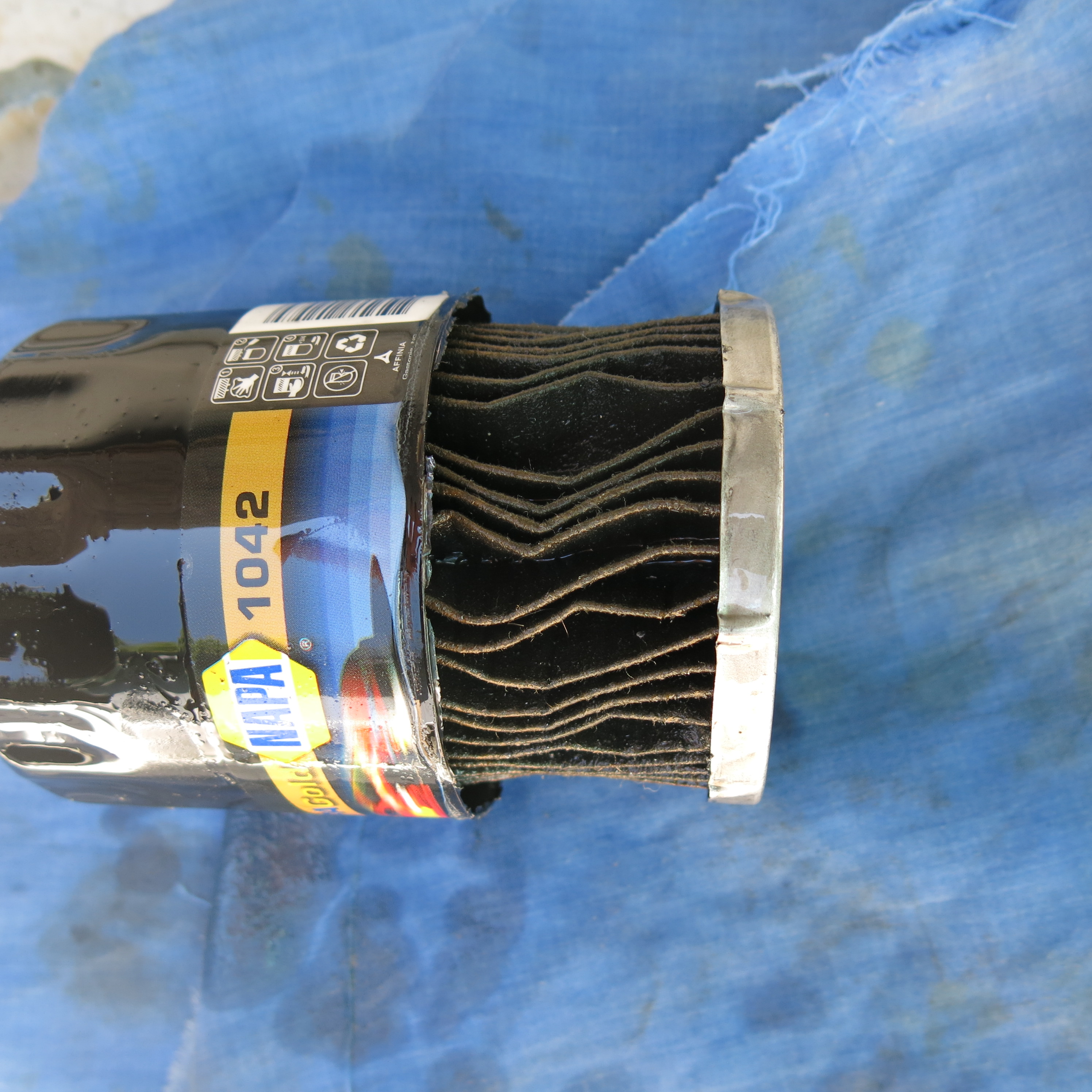

I recently did this and the short version is that when I cut open the aftermarket spin-on oil filter ,the pleats had collapsed !

Here is a photo of the collapsed filter pleats on a Napa 1042
That has a metal center tube, and the media isn't even dark yet, so it can't be very dirty at all.
Cellulose media. Just the way it is.

49 minutes ago, Ahsai said:
Why it collapsed?
I described the whole story in another Thread. The short version is the owner put Bardahl No Smoke and some other snake oil in his oil to 'fix' a  red 'Low Oil Pressure" Warning Light.
I did an oil pressure test and dropped the filter and pan. Cut the filter & voila. Correct oil+new filter fixed it !
