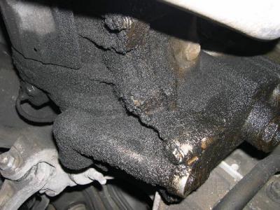

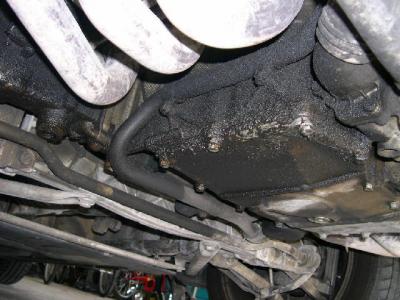

Thought I would change the plugs today as they are 9K overdue (dealer said they replaced plugs when I bought the car with 23K on it - found out yesterday they didn't). This is the mess I saw under the car. I specifically asked the dealer if the RMS was replaced and was told no. I have reviewed all 13 trips to the dealer by the previous owner and RMS was never replaced.
Where do you think all this oil came from? I suspected a valve cover gasket leak but think this is much more serious than that. The weird part is over the course of one year and 16,000 miles I've only seen a few spots on the garage floor near the drivers left wheel. I can't figure out if the spots are anti-freeze or oil.
Please advise. Somebody please get Orient Express some smelling salts to revive him after viewing these pics. Good thing I have another YEAR on my warranty. :jump:
From the pics, it looks like the oil build up is in center of engine around where engine and tranny mates. Looks like RMS to me but more pics of the leaking area would help.
Cam cover would be from the side of the engine. Didn't see that in your pics.

I suggest you spend a little time cleaning the engine and then take a look at where the oil is coming from.  You have many months of oil and buildup on it now.  Like Loren said, it could be coming from anywhere and may be a simple repairable leak.
Thanks for the quick response. The last picture in the sequence in poor focus IS of the area in the center of the car exactly where the tranny meets the engine and is the ONLY place I see fresh oil. It could also be leaking down for the top of the motor.
I am afraid if I clean the engine most of the evidence will be removed.
Looks like a trip to the dealer "as is". BTW - this oil build-up is more like six years of accumulation. I live on the coast and pulled handfulls of greasy sand out of the space between the heat shield and coils. What a mess! Maybe I should throw the dealer a bone and let them do the plugs - I don't want to think about getting sand in the cylinders...

Looks like it is coming from the side where the spark plugs are. Almost looks like what I had before. brought it to the dealer and they changed the spark plug o-ring. Also thought it was the RMS because I also hade oil near the tranny. now after the o-ring change and the engine and tranny cleaned, don't see any oil/gunk build-up. It was a $ 500 + trip to the dealer but as you said you still have warranty so it will not be a problem.

I finally got my car in to the dealer. The oil leaks are covered under Certified Porsche warranty. They were VERY nice and quick to point out the cam cover, cam solenoid seals as well as the oil protection pipe O-rings will all be addressed.
