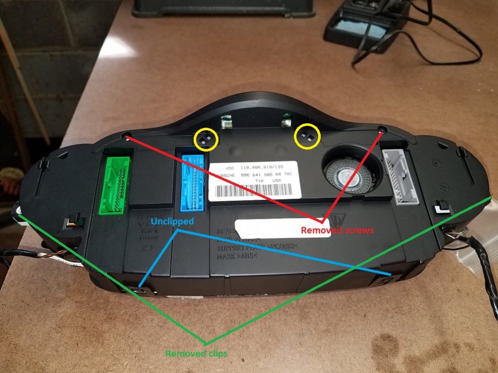

I am trying to replace the time adjust selector on my 996's speedo.  Referencing the pic below, I removed the two screws (red lines), clips on the mounting ears (green lines), and released the lower clasps (blue lines).  The front piece peels away at the bottom and the sides, but seems to be stuck at the top section.  What is holding it on there?  Are the yellow circles clips?  I'm reluctant to put too much leverage on the plastic piece

Figure 20 maybe...nope...appears different than yours.  However, there is probably another clip on top that needs to be released.  It could be the  two yellow circle items and a small flat blade screwdriver to gently pry on those.  Just guessing....

The tab Ddavidoff shows is on the front bezel.  I am trying to split it at the yellow arrow below.  I did give it a shot with the credit card on the front bezel.  It didn't come off, but I haven't given up on that one.

I have had to open mine a half-dozen times this month--chasing down and replacing the LCD screens. That top clip is a hidden one, tricky. Also, there are some clips that hold the giant plugs to the back that need to be released to pull off the circuit board if needed.

The first time I took a risk and used some force and it just popped loose, but mine is from a 2000 C2 so slightly different. The next couple times I used a guitar pick, and finesse, to slide around and force it apart. I am not sure being careful is helping me since it just gets easier to open every time. I have one last LCD to replace--we'll see how it goes.
