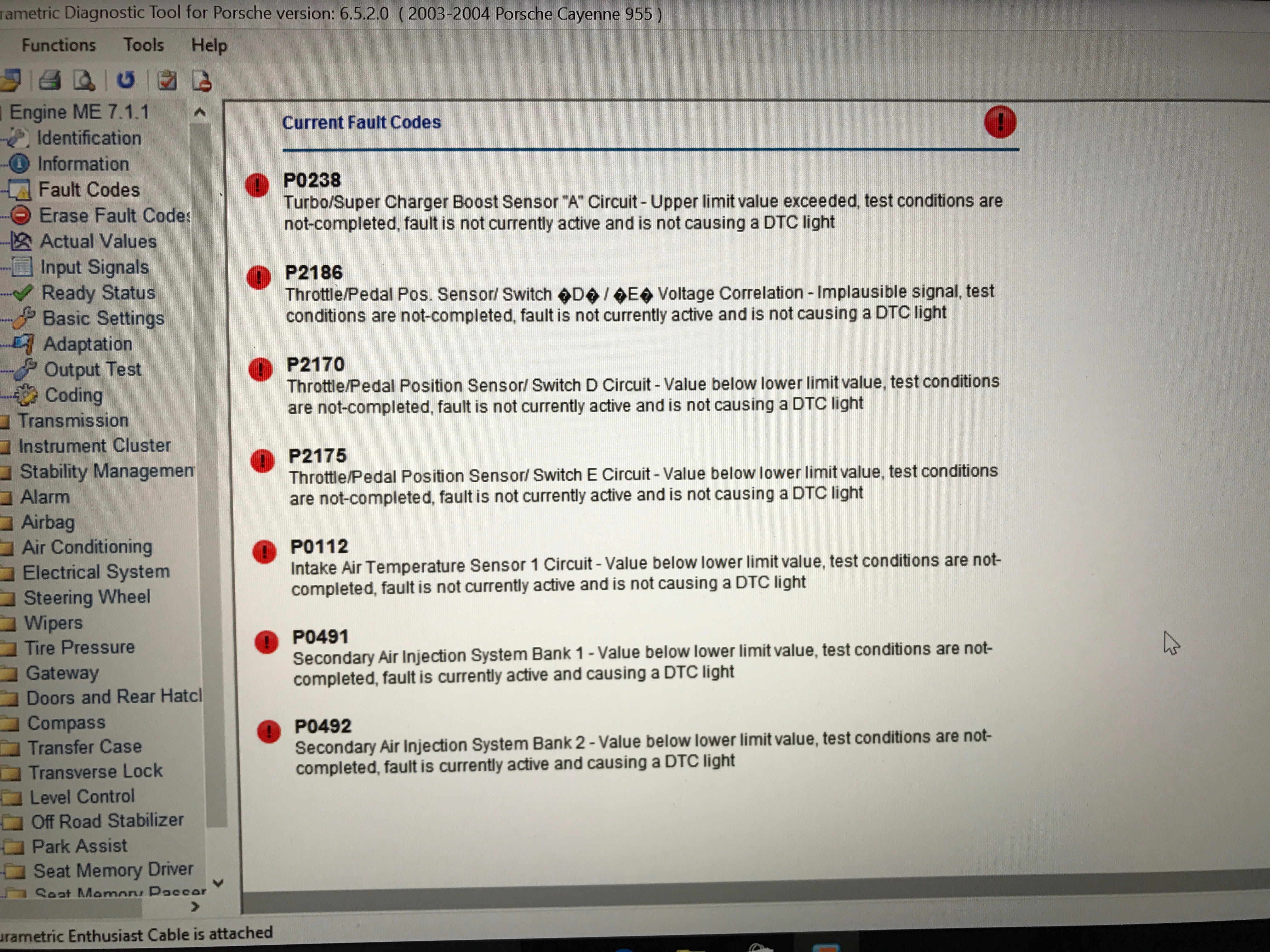

A week ago I had an issue with my secondary air injection system on bank 1, got P0491 and rough / weird idle after coming to a stop after freeway driving. I checked the secondary air pump and sure enough it didn't make any sounds or vibration on cold startup on the passenger side bank. I replaced that pump, then had an unrelated water pump maintenance event (smelled coolant, saw play in the pulley, and replaced the pump and pulley).
I blew down the passenger side SAI hose and it was fairly difficult (I thought I'd give myself an aneurysm), and sucking didn't pass any air. I believe that's the correct operation.
A day passed, and now after coming to a stop after freeway driving again I look down and see CEL illuminated, and after scan P0491 and P0492. It seems unlikely that both the new pump and the old pump are dead. I had a bunch of other codes from turning the car on to accessory status while the MAP and N75 solenoid and a few other things were unplugged while replacing the water pump. I'm hoping that the DME was just confused or something.
Any ideas why suddenly both SAI pumps would show as failing?

The first 5 codes are exactly what you see if you switch on the ignition with the map sensor and throttle body disconnected electrically. Ask me how I know. Clear codes and do the throttle body calibration either with the software or just ignition in and don't touch throttle pedal and don't start engine, after 1 minute switch off ignition and then back on and start engine, idle for a few min and go for a normal drive.
The SAI codes I also have them on the very rare occasions it will need a cold start. These SAI are prone to failure due to age but also the check valve leaks and let's hot exhaust gases and carbon fry up and coke up the SAI internals plus the fan blades like to snap off and get lodged in the check valve.
You don't really need SAI, (emissions blah blah and quicker cat warm up to get into closed loop) you can plug the pipe with a 3/4" GI threaded plug and jubilee clip and ignore the code. Cold starts might be a little lumpy as the cats take a few seconds longer to heat up but who cares.
This is what I did because the check valve is a real b * tch to get to at the deep back of the engine.
Saves money and it cant break cos it already broken .......

Yeah I'm less concerned with the first 5, I had to change ride height while working on the water pump to get comfortable so I had to turn the vehicle on. I just didn't bother clearing afterwards, but I did let the throttle re-adapt and heard the normal clicking sound associated with it feeling out the range of travel of the throttle plate.
My passenger side SAI pump was seized and seemed to have truly just died, that's why I replaced it with a brand new one a week ago. Seeing both showing some error is pretty alarming. At startup everything seems fine, it's after I come to a stop after the freeway when SAI pumps kick in again for emissions that I get the CEL. It was pretty lumpy and clearly stuttered when the passenger side pump was dead, and returned to smooth after I replaced it. I have no idea why both showed up today as I felt and saw no change in revs.
I found Loren's P0492 troubleshooting document in another thread and will work through that.

Well I fixed it. Turns out when the SAI Pump died it also blew the fuse. I thought I visually checked it but accidentally checked the wrong one. Replaced the fuse, and everything is great, no more CEL or issues.
