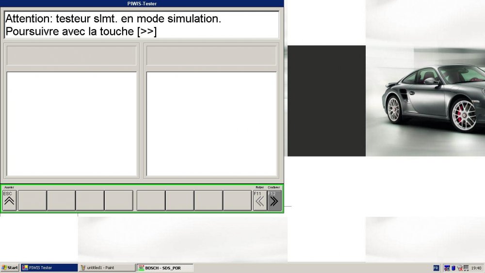

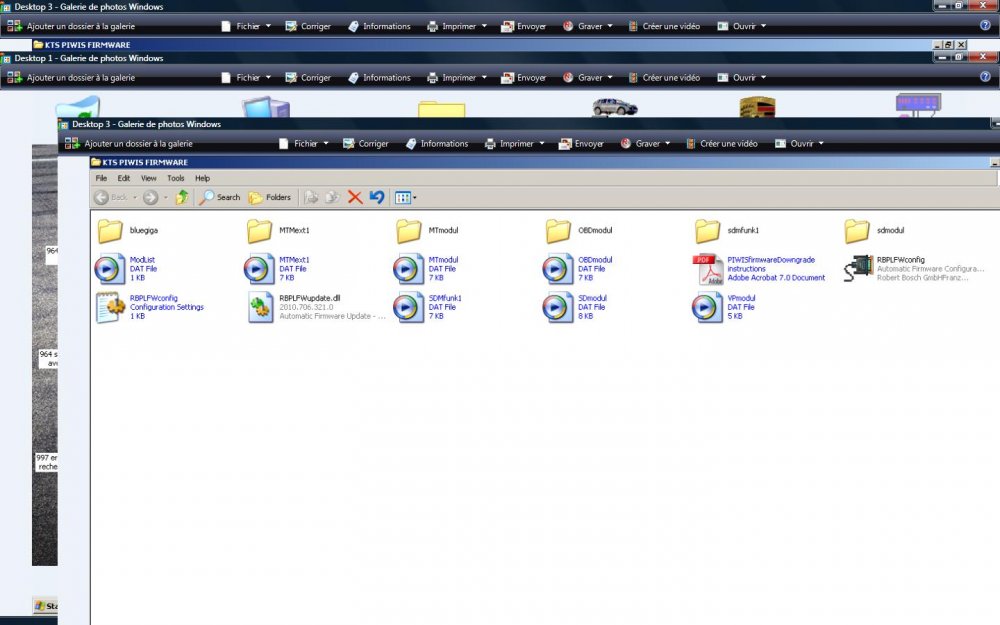

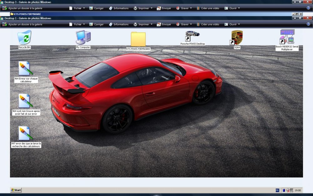

I need help tu use my KTS 520 with my laptop Dell piwis V34. When i try it on a car the tester stay always in simulation mode. On my deskop i have firmwaire uptade programme but i don't know how i must use it. Does somoene know how doing it please ? Thanks for your help...

If the KTS is connecting to the computer it might be a firmware issue.  To update the firmware, you should try doing it from within PIWIS first.  Go to Tools > Firmware Update.  The firmware flashing process should take 2-3 minutes.  If the Firmware Update screen appears for a couple of seconds and then disappears, the flash was unsuccessful.  In that case, try updating it with the Firmware tool.  Run RBPLFWconfig in your Firmware folder.  Choose KTS520, USB connection, ForceUpdate, and Firmware version IP09.  A COM1 connection would be better, but you need the special Bosch serial cable to use it.  If it flashes correctly, you will see a progress counter.

1 / Yes when i run piwis diagnostics it try to connect with the 520 ( it makes the sound ) only on 997, 987 and cayenne ( picture 1 and 2 ) but not with the other car ( picture 3 simulation  ).

4 / I try with the RBPLFWconfig but i don't find version IP09 ? ( picture 5 ) . I try with the usb cable but i stops with the message could not open port ( see it on back of picture 5 )
