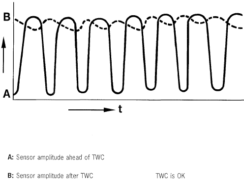

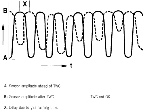

Check engine light came back on. Now its code P0430( actually this might of been the initial code). Sounds like the 02 sensor is bad. What do you think Loren?
Is that the only code? or are there more?
What are the O2 sensors voltages and do they vary or are they always the same?
See the graphs below...
TWC - OK
TWC - NOT OK
This is the only code. I have no idea of the 02 sensor voltage. I had the code read at Autozone. Only other information I received was: The catalyst system efficiency for bank 2 is below threshold for the current engine operating conditions.
I would find someone with a full scanner and make sure. This code says you cat is bad - if no other codes are present and the O2 sensors are reading correctly. A cat failure is not unheard of but it is not very common as far as I know. And, a new cat retails for around $800!

Well, if the cat is not doing it's job then the O2 sensor will tell the DME to make the fuel mixture leaner or richer. At some point it will not be able to maintain proper mixtures. Potentially it could run the engine way too lean and cause damage or way too rich and waste fuel.
To my knowledge there are only two or three ways a cat can go bad.
One is that it becomes clogged with debris - from rusting and breakdown of pre-cat pipes or the cat breaking down itself.
The second is that it becomes contaminated. Some engine oil additives or engine problems that cause the mixture or the temperature of the exhaust gases to change can reduce the effectiveness and life of the cat. Leaded gasoline and the over-use of fuel additives are said to shorten the life of a cat considerably. Even some gasket sealers and cements can contaminate a cat.
Finally, physical damage to the cat by backing over something or being struck (as in an accident).
