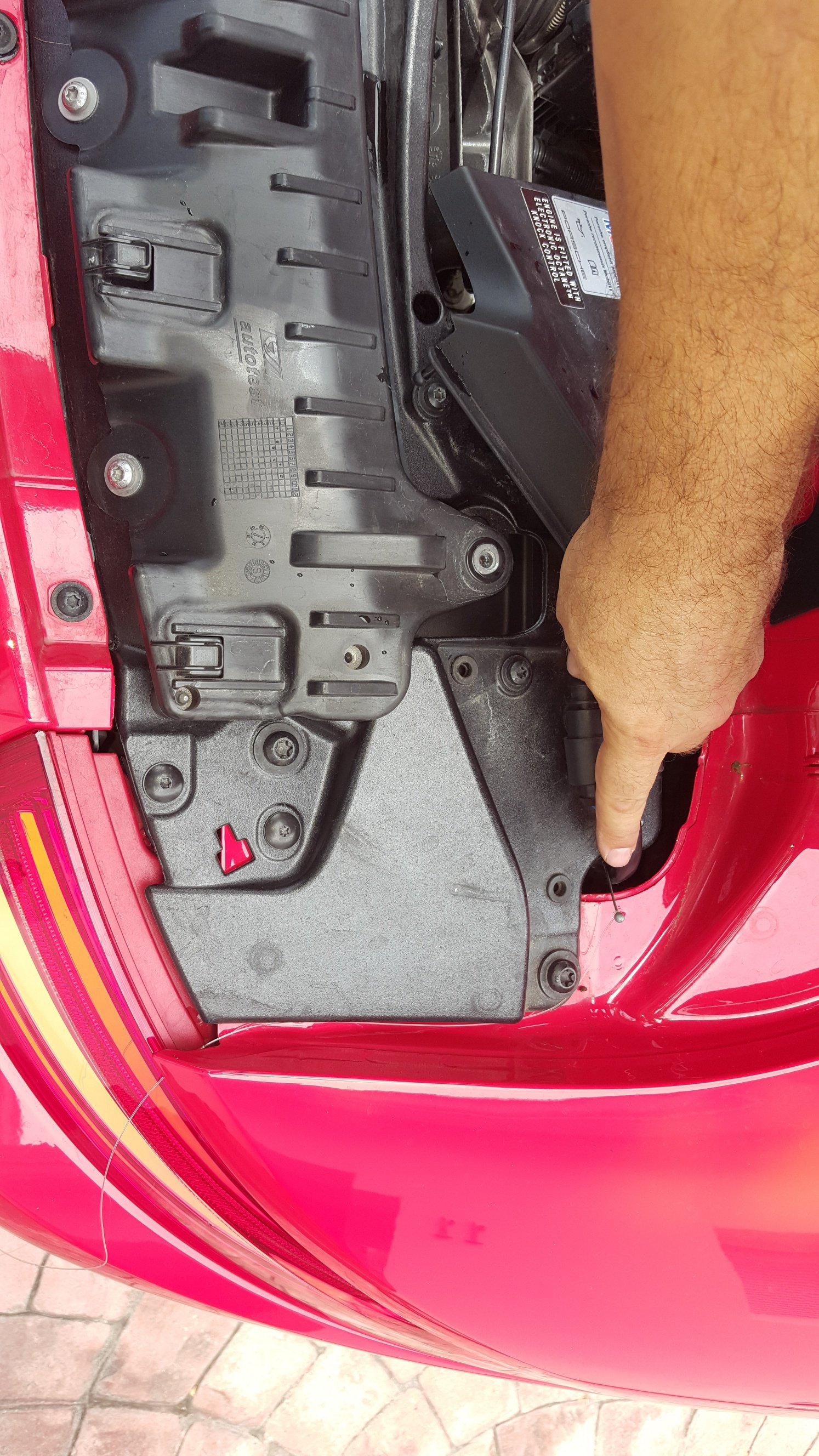

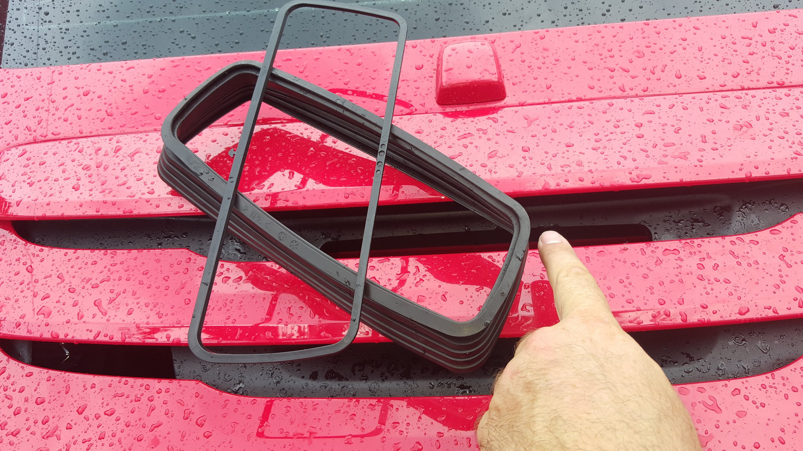

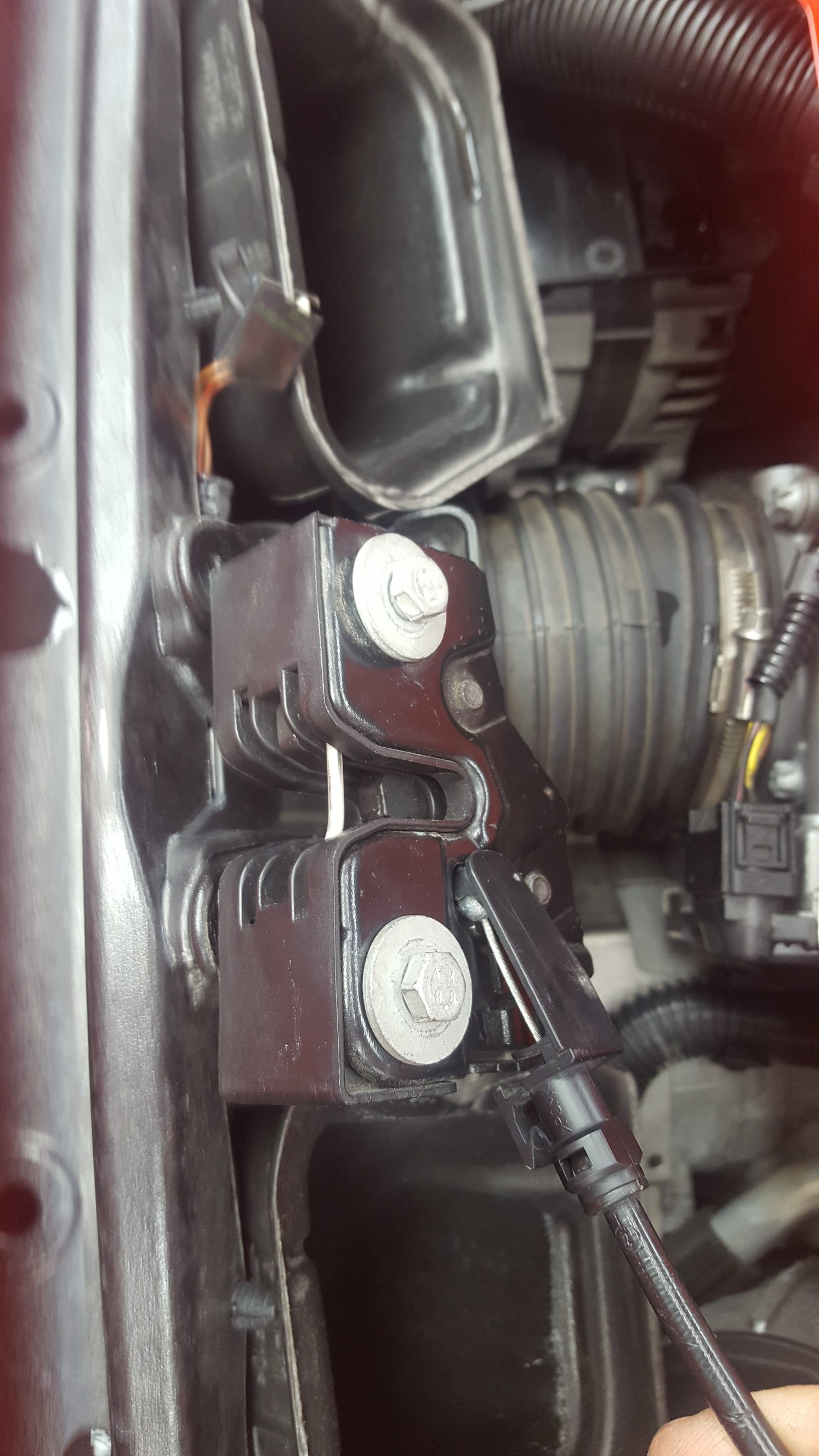

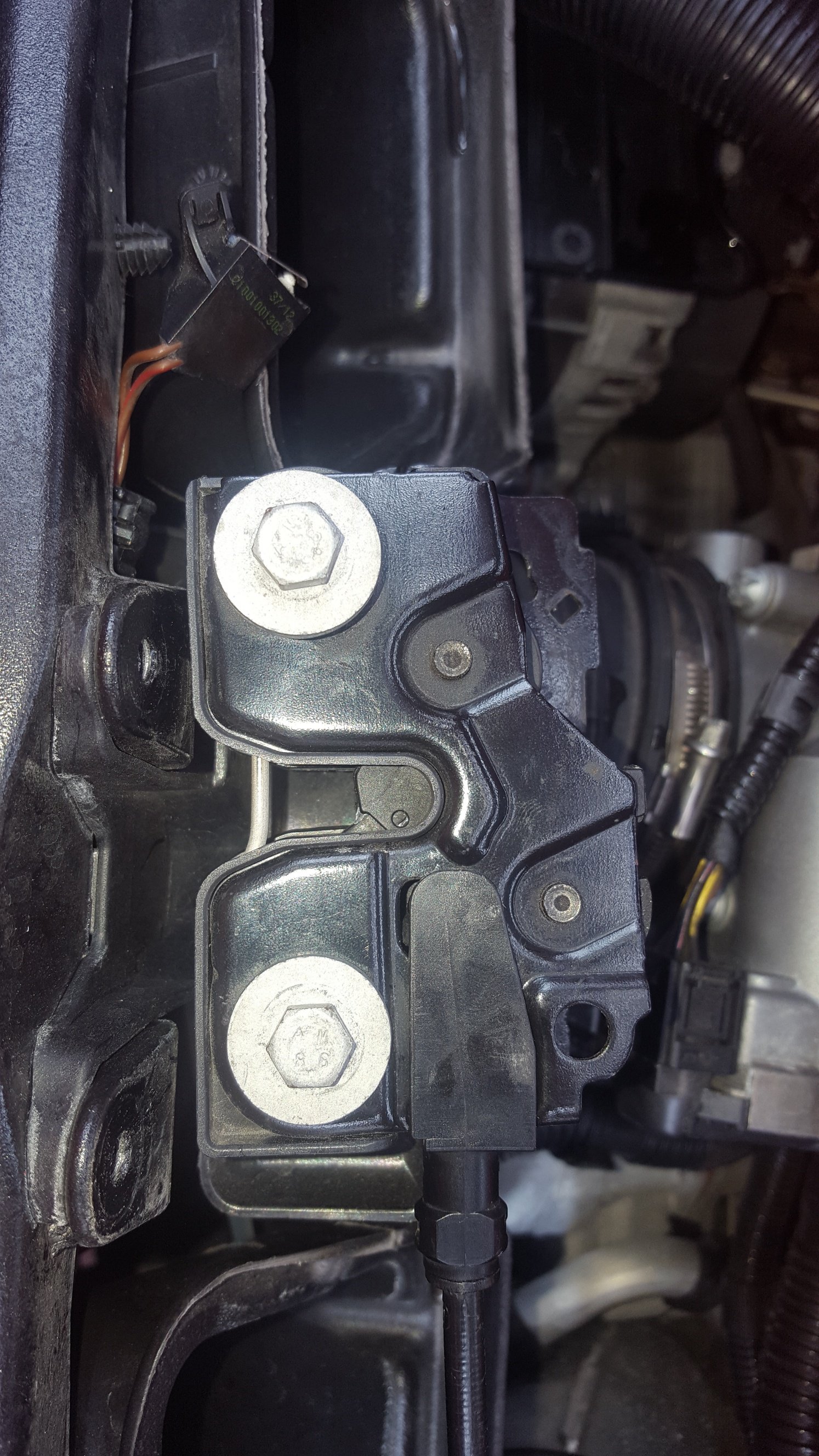

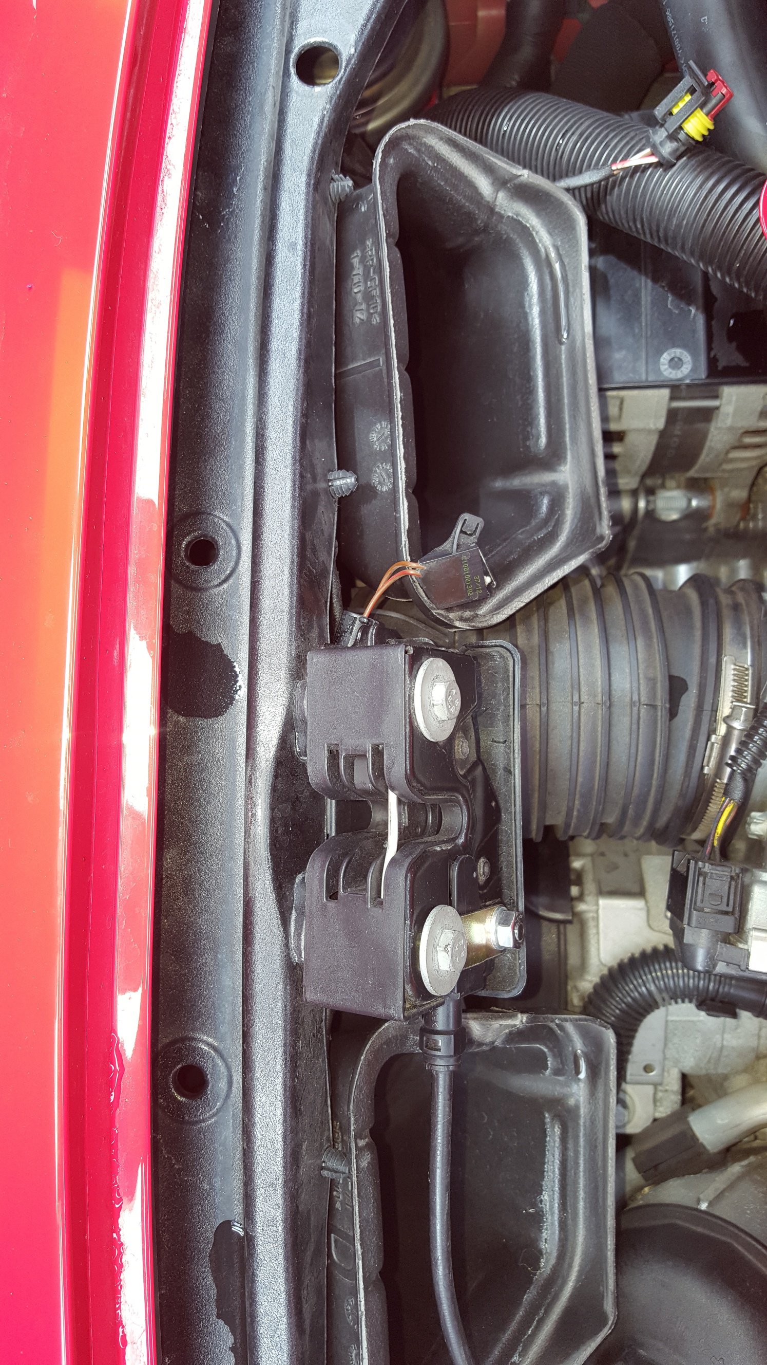

Follow-up ... I found a post which showed that on a car with an electric wing, one can reach the latch from under the raised wing. Since my car has a fixed wing, I could not do that. Instead, I reached through the louvers of the deck lid (pic1), removed the rubber shroud that goes to the intake, reached in under the black plastic cover of the engine (used a few rags to hold the plastic pulled apart), and was able to see and  push the latch with a long screw driver, right where the cable was supposed to attach. Pic 2 shows the disconnected cable and, pic 3 and pic 4 show how it connects. The issue is that the plastic clip holding the cable is not to strong and pops out easy. Part of the issue is that the cable attaches to the air intake (pic 8), and every time you pull out the intake pipe, like when you change oil, you put strain on the cable and it can pop out. My solution was to fabricate a small bracket (pic 5), and bolt it on top of the plastic clip using one of the bolts holding the latch mechanism plus an additional 6mm bolt which I added to an existing hole on the latch (pic 6 and 7).

THANK SO MUCH TO IVO, I was able to release my engine lid. You need to left the plast portion of the middle slat and use a long flat head screwdriver, mine is 8" long. You then pry apart the engine cover (the cover that holds the two engine fans) with the screw driver and you can see the actuator. You then can release the actuator using the tip of the flathead screw driver and pushing towards the passenger side of the car. This should release the actuator. Happy to pay it forward to anyone that gets stuck with this.
