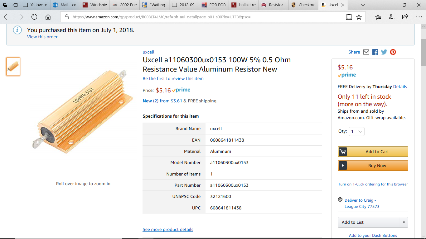

Just a note rather than buy the £126GBP (per side!!!) resistors from Porsche, I replaced mine with a pair of heavy duty 100W x 0.5 ohm resistors from ebay, £2GBP each......
Just cut wires off the resistors and solder on new ones.
