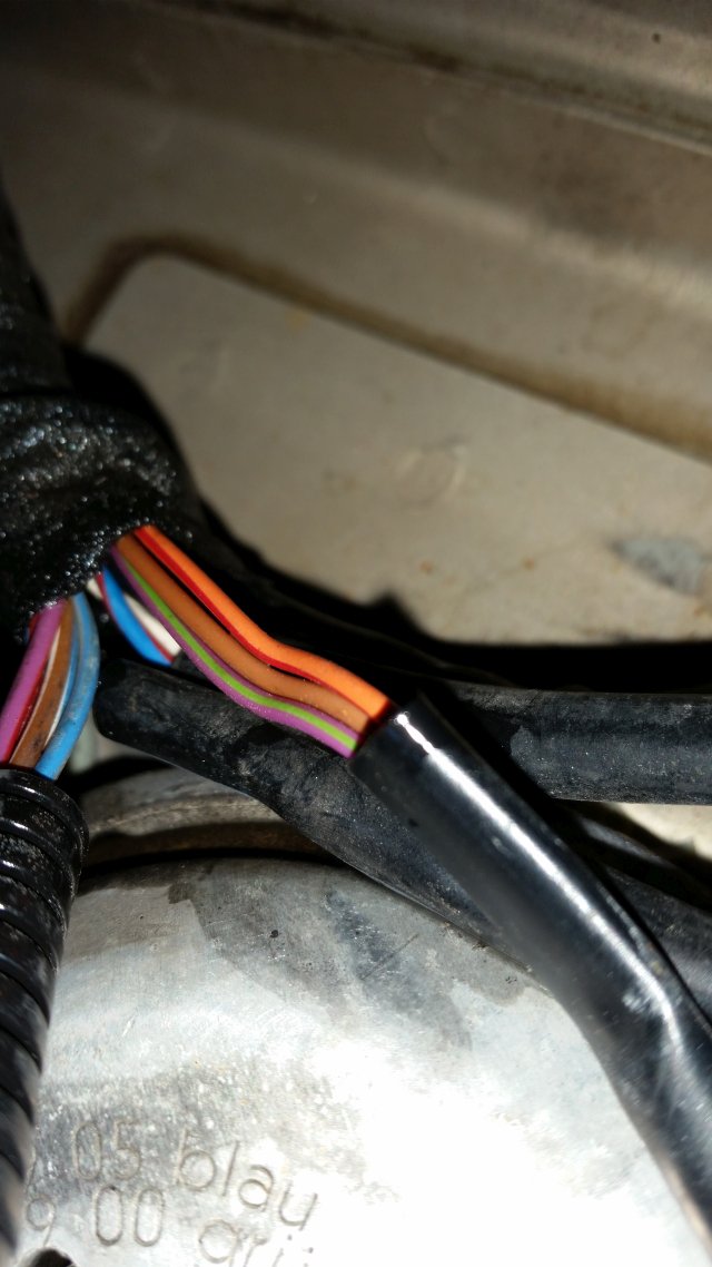

While I was looking into the problem I found a connector the was not connected to anything. It is on the passenger side, in the engine compartment just in front of the taillight. It is a six pin connector with only 3 of the connections populated. There is a holder for the connector but no mating connector is there. The holder is the same one that has the connectors for the O2 cat sensors.

The first photo is the connector, the second photo are the wires connected to it going into the wire loam.
19 hours ago, Ahsai said:
It's for diagnostic and it's not connected to anything.
Thanks Ahsai. I did see the holder as well.
I searched for any information about a diagnostic connector but the only thing I found was for the OBD port. Do you have a link with any more information? Is there a tool I can get to connect to this port?
