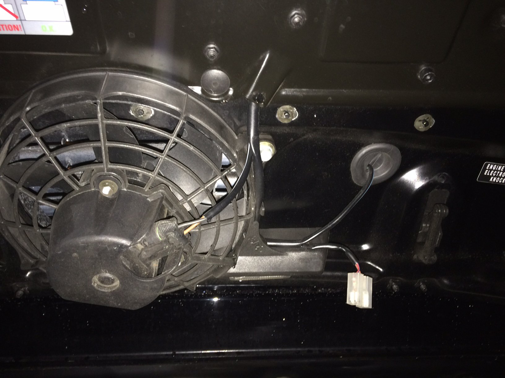

Can you identify this connector to the right of the engine fan?
I found this two prong white electrical connector unplugged (see picture; located just right of the engine fan) on my newly purchased 2003 Porsche 911.  It appears to plug into the connection located behind the rectangular black box adjacent to it.  Could someone please tell me what this connection is for and why someone would  want it unplugged (assuming there is some reason other than someone unplugged to do something and forgot to plug it back in)?  I just thought I should know what its for before I plug it back in.
I did search, but couldn't find an answer - much thanks for your help.

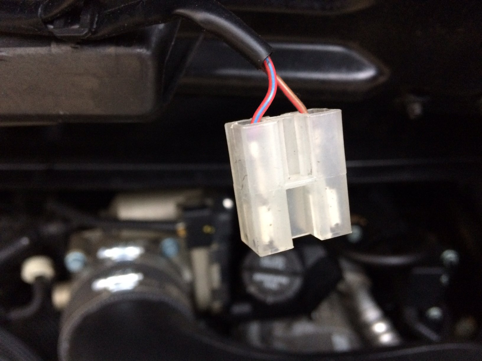

Sorry, can you tell me the number of wires and the color code of each wire?
I am uploading a close up picture (see attached), but there are two wires.  One is brown which I assume is the ground and the other is red/light purple striped.
Thanks for your continued help!
Just to clarify one wire is Red/Light Purple or Blue and the other is not solid brown.  I think the other is Brown/Red.

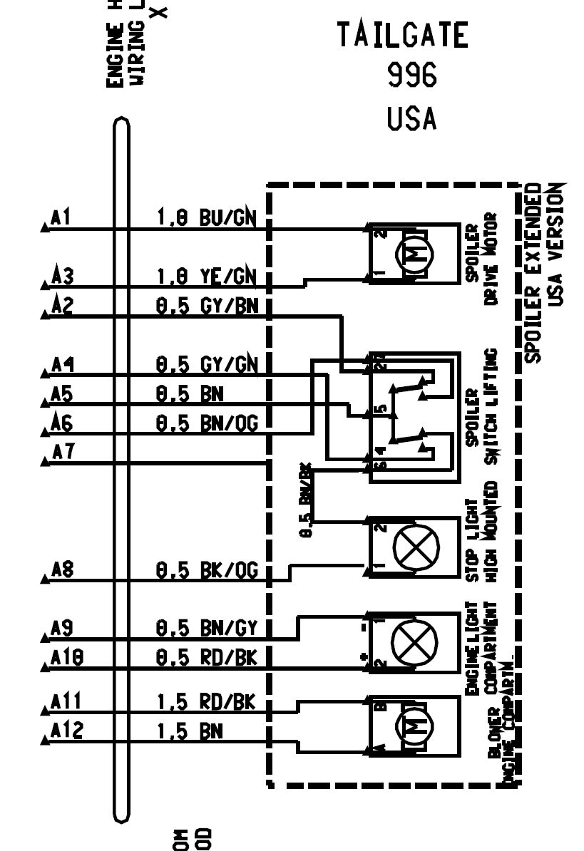

Loren - based on your wiring diagram it does not appear to be related to the spoiler.  Could it be something else tail gate related?  Third brake light, engine fan, etc.  Happy to supply more pictures if that helps.
I think this is for either the third brake light in the spoiler, or more likely the engine compartment light.  The spoiler light is only activated when the spoiler is in the raised position.  The engine compartment light should come on when lid is open.
