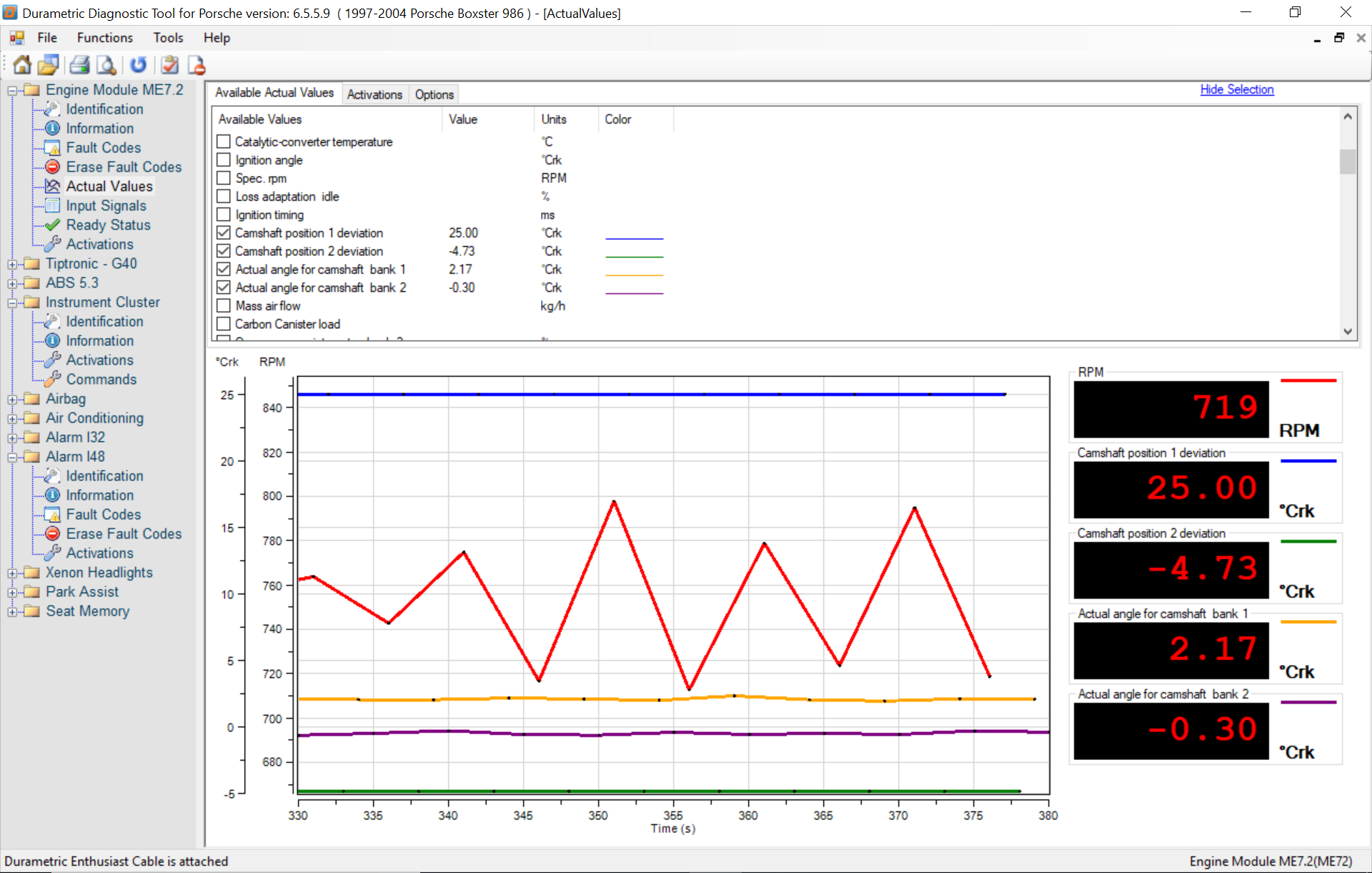

The fact that it is on a single side of the engine helps rule a few things as less suspect.  Use the Durametric to look at cam deviations.
Am I reading the fuel trims correct though?  Bank one seems ok but bank 2 is running rich isn't it?  The codes are all for bank one. I thought anything less the 5% was normal for long term.
Cam deviation is the first thing in the list Wednesday when it arrives.
Car had been running great then strmarted to through temhe misfire codes.
I have a new cam sensor but haven't installed that yet, waiting to see what the timing is first.
