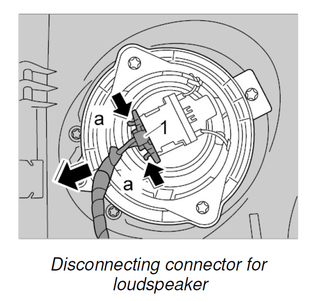

My 2014 Cayman S with Bose has a right rear speaker blown. I ordered the part but can anyone point me in the right direction for its removal and reinstallation. I can't find anything on it. Thanks in advance.
Undo fastening screws 1.
To reduce the unclipping forces and thereby the risk of damage during removal, the removal steps must be carried out at the accessible connection points using a suitable tool.
Unclip trim panel for spring strut mount 2 first upwards Arrows A and then pull out slightly in direction of Arrow B.
Check fastening nuts 1 and clamps 2, 3, and replace if necessary.

Did anyone figure this out yet? I'm most of the way there but need help. I've got the entire storage/speaker bracket removed but can't figure out how to get the **** speaker out. Please shoot me an email if you can help. brian dot penn at hotmail dot com. Thanks in advance!
