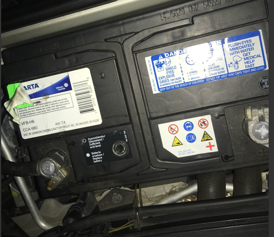

On second look at the battery, it is a Varta H-6. Found it online here: https://worldimpex.com/part/battery/2320H6VAR/ and at pelican parts: https://www.pelicanparts.com/More_Info/H6VAR.htm?pn=H6-VAR-INT
Retails a lot less than the $354 they quoted me... also, they quoted me with an H-7 battery and put an H-6 in there. Don't know what that means but it is suspect. Maybe they would've put the battery I was quoted on in there if I signed off on it initially but something tells me that was the battery they would have always put into it. Even more ridiculous is that they told me that I can buy and put my own new battery in there and give theirs back to them OR pay them the quoted price.
As far as manufacturing date I haven't been able to find it, though there is a green sticker with 11/18 on it? I'll attach a pic of the battery if you want to take a closer look.

Manufacture date codes on batteries can vary so it is hard to say for sure, but my guess is that the important numbers are 758 which indicate October 2017.  Additionally, Varta batteries used to have a date code engraved on the negative battery terminal, and there is not one on yours.  That terminal appears to be a little beat up in your image.  Varta may have stopped doing that, though, there is a lot of conflicting information out there.  H6 and H7 are the case size, and H6 is the correct size for the 986.  Some of the 911's (and I'm sure other Porsches) use the H7 and H8 size.  Of course, price increases with case size (i.e. battery capacity), so the H7 quoted is more expensive than the H6 installed.  Yet another indication of shady behavior and poor business practices.

And jeez my original battery that they took out and made disappear was a year younger than that. WTF
