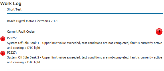

So I did some more data-logging today during a portion of my morning commute. Mostly low speed (below 25MPH) stop and go but a couple of places where I could really go fast (30-35MPH). If I am understanding and reading this data correctly my check engine light codes P2227 & P2225 are being caused by a vacuum and/or boost leak? Take a look and pay attention to time slots 12:59 & 16:57. Something weird happens both times when it feels like the timing is all of a sudden thrown off, and the truck hesitates, stumbles, loses power, and then snap crackle pops through the exhaust like a cheap rice rocket with a fart pipe. And each time this is with a steady easy throttle no mashing.
