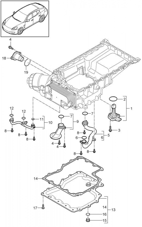

It is the same or similar sensor but is mounted in the back upper oil pan and the engine carrier crosses behind the lower pan a couple of inches below the sensor. My thought was to unbolt the right side engine mount and raise the engine an inch or so to make room to get the sensor past the space between the lower pan and engine carrier.  If that doesn’t work the lower frame that supports the front end has to be dropped because the bolts that go through that then go through the engine carrier to the chassis. After you remove the lower frame you can disconnect both motor mounts and remove the engine carrier. It seems like a ridiculous amount of work to have to do to change the sensor that in  most cars would only take five minutes. That is why I was hoping somebody with more experience would have a better idea of how to do it without all that work.

On the V8 engines it is at the bottom of the oil pan.
Use:
958 606 160 11 Oil Level Sensor  -- US MSRP $130.48
038 103 196 B Sealing Ring  -- US MSRP $5.00
N  015 082 13 Hex Nut (3 required)  -- US MSRP $0.26 each

On 8/5/2019 at 1:10 PM, Noblestar said:
  I believe that is up to 2010. Unfortunately 2011 - 2014 it is not it is in the higher part of the back of the pan. The engine carrier crosses behind the lower part of the pan.
