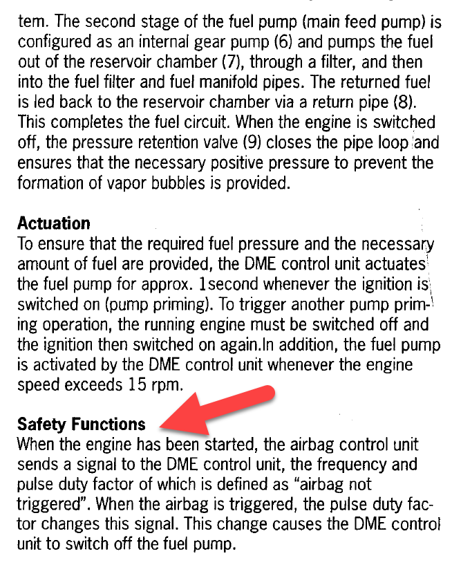

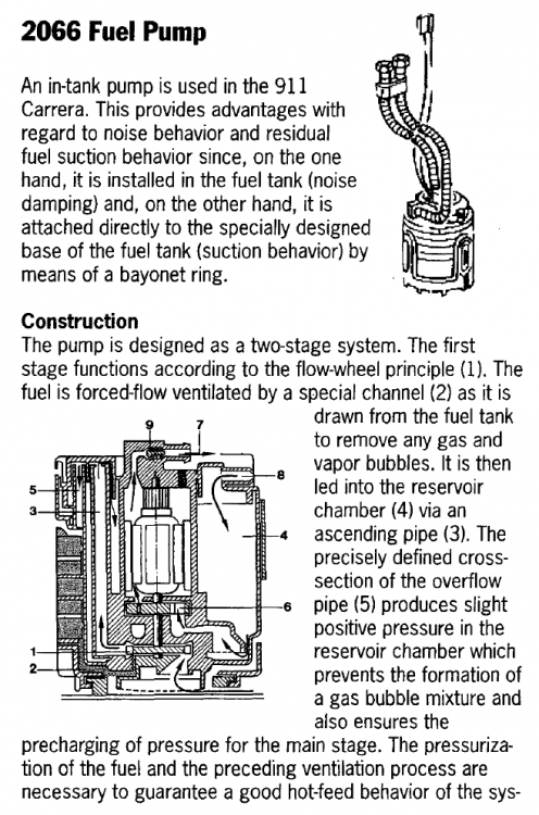

That’s how I thought the system worked, without a separate switch or control system.
If the air bags deployed, that needs to be corrected before the DME will allow the pump to run.
P1397 code is for an “implausible signal” from the sensor, which may be a wiring issue.
