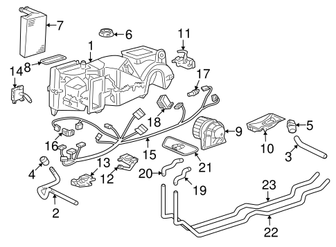

Referencing this picture from pelican parts:
When running the AC for a while, the line with the green arrow grows cool to the touch, but only by a few degrees cooler than ambient. The larger line by the yellow arrow is at ambient temperature if not a few degrees warmer. Both lines coming off the back into the cabin are ambient temperature as well.

From what I've seen it's a pretty general term for the HVAC box under the dash. Apparently almost all the parts contained in it cannot be bought individually, or even viewed in most part diagrams.. and it's a pretty complicated system, so if something goes wrong in there, sourcing a new one, replacement used part, or any single part is nearly impossible. As they say though, start with the easy/simple stuff first and work your way through, and getting my refrigerant checked or flushed is what I probably should've checked first.
Every part in the HVAC system is available separately:
