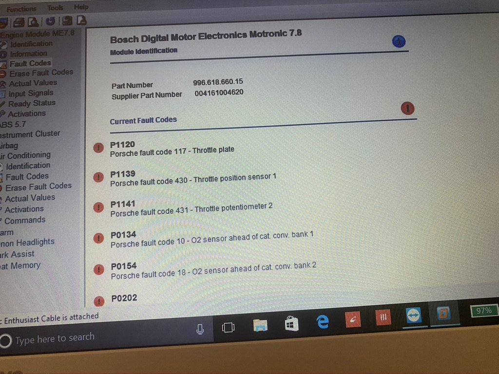

A check engine light on simply means one of the parameters the ECU monitors was off, and it always records a code that tells you specifically what was wrong.  There are literally thousands of various codes that will throw the CEL.  Next time, read the code before you clear codes.  That code or codes will point you in the right direction.
Also, I would  get in touch with whomever did the LS3 conversion and ask them how they rigged the "fly-by-wire" throttle conversion.  There is going to be a lot of frankenstein parts involved with an LS3 conversion.  Just the fact the GM OBDII port didn't work but the Porsche OBDII port did is really questionable.  Did they somehow "marry" (connect) the Porsche ECU to a GM ECU?  How?

No, I believe both ECU's have their own job...  The Conversion utilized the GM gas pedal, so like you I was surprised when the Porsche OBD port cancelled the check light.  It has been years since I hooked up the Durametric program, but I did today with these results...
I just thought I need to see if I can date when these codes were thrown...  At the top of the attachment it says, "Current /Fault Codes.  I want to get to the bottom of

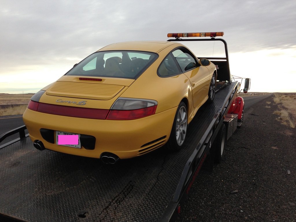

this pretty quick, I've never have been flat bedded home so far.  I did get stuck in Winslow, AZ for one night with the original engine.  The idler pulley bolt backed out,
a local towing service came out with his flatbed, took me to the Chrysler dealer, charged me $85..   They had the Porsche dealer in a neighboring town overnight
the parts.  I was on the road again by 10:00 the next morning...  All in all it was a memorable experience and meant some nice people.
