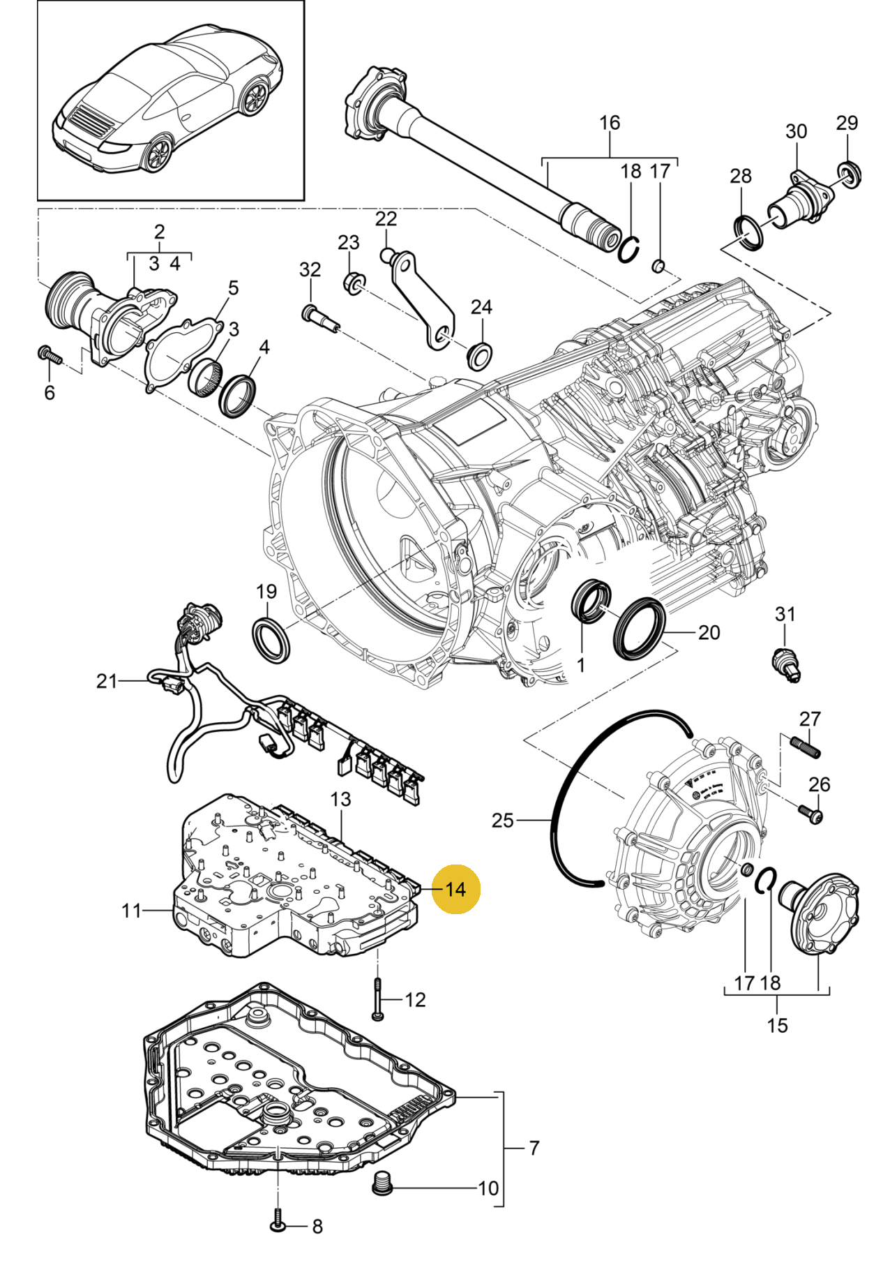

Thanks for the response. It looks like the CAN drive is the common denominator in all three of the codes, except the transmission code.  Looks like this is beyond my pay grade.  So I will have to bite the bullet and take it to a dealer, which is 2 1/2 hours from my house.  Also do you have any idea if the PDK control module is inside or outside the transmission? Reason I ask is that is if it’s inside the transmission, it basically totals your car as it’s $20-$25k to replace the unit from Porsche.  Also it seems weird that the car would loose it’s programming but I guess that sort of thing can happen.  Thanks again for the help.

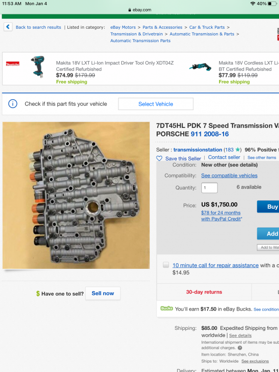

Drove it to work and back, about 30 miles no issues.  Just dropped it off at the independent shop as Porsche is 2 1/2 hours away.  I’ll keep everyone posted.  Just a side note, not sure if it’s related, but the dash display that shows what gear the car is in has never shown R for reverse.  By the way, the pdk control unit looks like a valve body with solenoids.  I’ve seen this part on eBay for $1750. Any knowledge of this part being of decent or bad quality?
