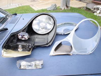

You may also want to try a hairdryer in a localised spot and start working around the perimeter to soften the adhesive and maybe use a butter knife etc along the seam?
A heat gun can soften the silicon to pry the housing apart. I doubt if it's worth the effort since you can't find a new lense alone anyways.

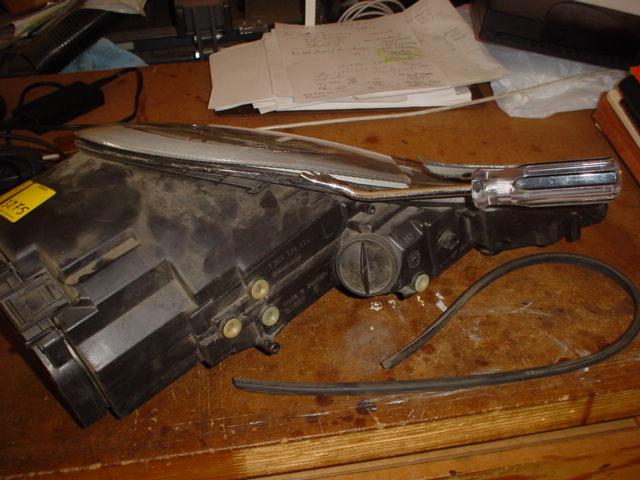

Well then put one in the oven and see if you can separate the clear plastic top from the black plastic base. I pried one apart without heat but I broke everything. There is a rubber weatherstrip and some type of adhesive that holds them together.
