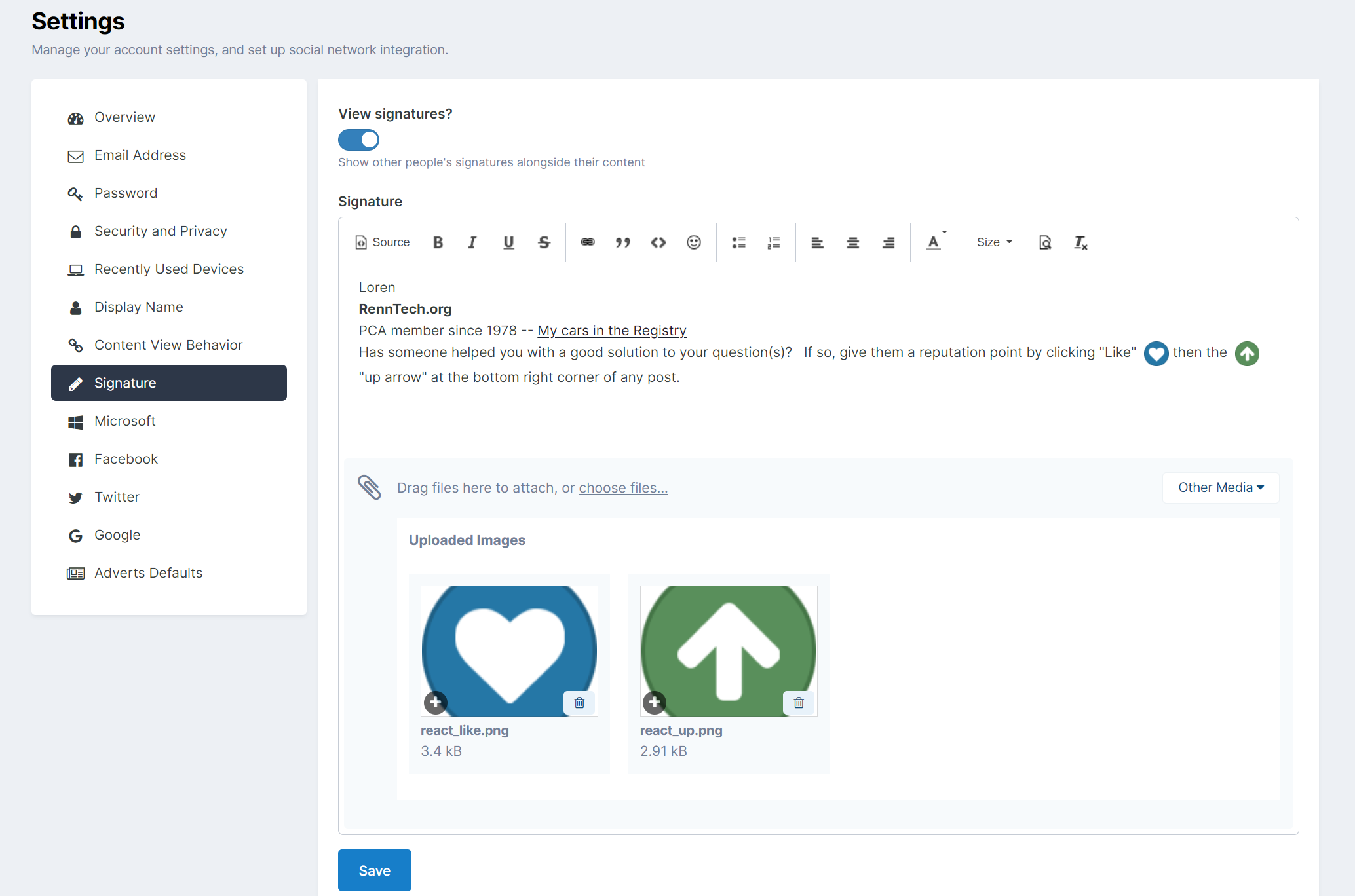

There's probably a way I can put all that info in my signature, so it shows up in every post ...
17 hours ago, Keith Upson said:
Rats. Well I haven't yet figured out the magic solution to having a post signature ...
Just go to your name at the top right then choose Account Settings - then Signature.
