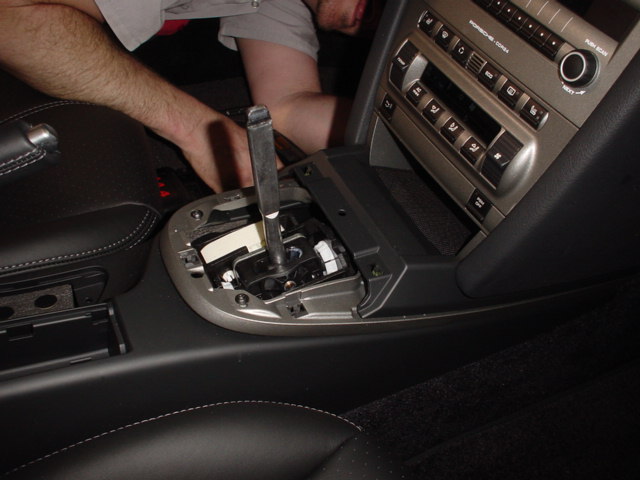

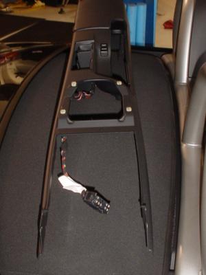

I have not seen instructions. I watched a mechanic I know do it because he had to replace an air bag control unit which is under the radio. Way different procedure than a 996/986. I took a bunch of pictures but it was dark in the shop and only a few came out. I did not make a note of each step but I think I could remember if a local owner gives me their car to practice on. :D
What is unique with the 987 is how you remove the shift knob. You lift up the boot just like a 986 but then you need to unlock the knob before you can pull it off. There is a black plastic locking ring that you rotate to unlock the knob - then pull it off.
