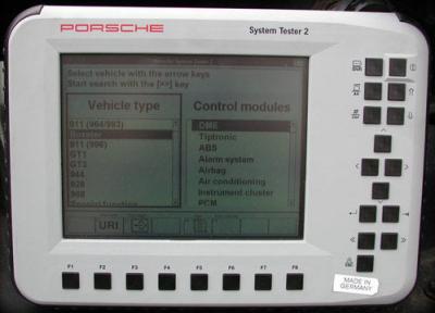

Here is my understanding...
The Porsche System Tester 2 (PST2) is made for Porsche by Bosch. Porsche has now changed over to a newer version called "PIWIS".
The original PST2 was derived from the Bosch KTS500 and the newer PIWIS is derived from the Bosch KTS 650.
It uses a specialized OS that's not quite Windows. You need to dedicate a laptop to the application. It also requires a hardware interface PCMCIA card.
Independent shops can purchase the testers and I have heard prices from $4000 - $8000 for the tester (with PCMCIA card and cables). The software updates come via CD subscription and run about $2500 per year.
Updated are as required by not more than one per month and usually much less.
I think Tool Pants has more pics of the PIWIS and the interface cards.

I saw a PST2 close up for the first time this weekend. It does indeed run a chopped version of Windows, what is odd though is it looks to be Windows 3.1 or 3.0, it is certainly a 16 bit system.
The actual software is a Bosch application, it is a simple EXE file that is loaded in place of the regular Windows shell. The interesting bit is the cable. This PST2 was a Toshiba laptop, not the (apparently) more common touch screen unit pictured above. The interface is a type 3 (double height) PCMCIA card that has had all identifying marks polished off it.
The cable is covered with a braided sleeve, the PC end has an apparently specialized 14 pin sort of mini-OBD connector that mates to the card. The other end is a standard OBD2 connector for the car.
The frustrating part was that it couldn't activate the OBC on my 03S. The menu structures do not precisely match what was listed on the various sites. Within the cluster section there was a similar option (Country?) but when we tried to open it the PST2 kept saying it could not do so until a scan had been completed, it wasn't clear what that scan was or how we would do it. Teh PST2 was connecting to my car ok though, I could view the mileage and other details and the CAN/MOST setup for the Bose.
So, I have OBC wires but still no OBC :( looks like I need to sweet talk a dealer but I'm loathe to pay an hours labor for a two minute task. There is an independent shop not far from here who also have a PST2, might give them a try. Very interesting seeing the PST2 in person though, the menus are a little funky to navigate and some of the menu options are kind of scary when you don't know what you're doing. I had sort of hoped it would have a simple serial OBD connector hanging off the back but no such luck!
Yes, the PST2 is a custom version of Windows 3.11 (Windows for Workgroups). I bought a used PST2 (Toshiba clone) from a shop that is converting to PIWIS (if I only had an extra $20,000 I would have a PIWIS too). The machine boots into the PST2 software and the only time you see a Windows 3.11 screen is during the printer setup. The OBD II cable connects to a Bosch custom (serialized) PCMCIA card in both the real PST2's and the clones. I guess they like the Toshiba laptops because there is a card lock that prevents the user from accidentally pulling out PCMCIA card out when the OBD II cable is pulled on.
